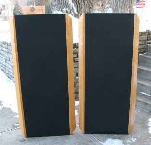

Sumo Aria by Highwood Audio
Avwerk: the speaker you are referring to was the Sumo Aria and was designed and manufactured by Highwood Audio of Calgary Alberta Canada. The review you spoke of was first published in Audio June 1992. There were also one or more reviews in Stereophile on Hybrid versions later. Sumo had financial troubles and the team of Sumo (distribution) and Highwood (manufacturer) split. Highwood Audio then merged with Museatex Audio (Ed Meitner) and released a new version under the Museatex name. That went for a couple of years until Museatex management killed the speaker after ******* around with it. The speaker was designed by myself Paul Burton and John Wright. John has since taken over service and modification of Museatex and Meitner equipment as well as designing new equipment, Paul is now back working in Britain and I am designing ausio cables and interconnects. Was a good design as a point source. Our first version (and best) was a line source which we never got to market. Maybe some day who knows. Ed carried on to start EMM Labs which you probably know about and is still here in Calgary. Hope that this helps.

The motor used H7 ceramic magnets the pole was vented and the magnet cavity was vented. The pole had a full copper sleeve and there was also a copper shorting ring at the base of the pole and a copper ring inside of the top plate. Theses were necessary to achieve extnded bandwidth. We used fero fluid in the gap to act as a liquid bearing to help keep the voice coil stable. The coil was a four ohm single layer coil again to minimize inductive roll off. There was just over one tesla in the gap. Top plate was 3/8 inch thick. Voice coil was 1.25 inch kapton with a coil of around 32 or 34 guage. The voice coil gap was about the same as a typical dome tweeter. You can imagine this as a bigish tweeter with the worlds biggest suspension. Diaphragm was 150 guage mylar HS. We looked into using neo magnets but they were still on some military list back then and supply was not a dependable thing then.
The line source came first but we were worried that the magnet structure would cost too much. That was before we added alll the tricks to the point source motor. We built both single ended as well as push pull versions of the line source. We used H5 ceramic magnets with iron pole pieces. Efficiency was not too bad at an honest 87 db (not just at 1KHz). I think we used 32 - 34 guage magnet wire (copper clad aluminum). There were eight or ten turns connected via a harnes so all the turns were in the same direction. The stage and image qualities of this speaker were world class I don't think that I have yet to hear the equal. That's about all I can recall at the moment. The real trick is to deal with terminating the traveling wave as it reaches the frame where you don't want it to reflect back into the diaphragm. Regards Moray James.

Sorry key miss hit and cant see any edit button....thread brought back becaue I was blessed to have come upon a pair of these in like new shape and they sound unlike anything else I have ever laid my ears upon......heavenly to say the least
