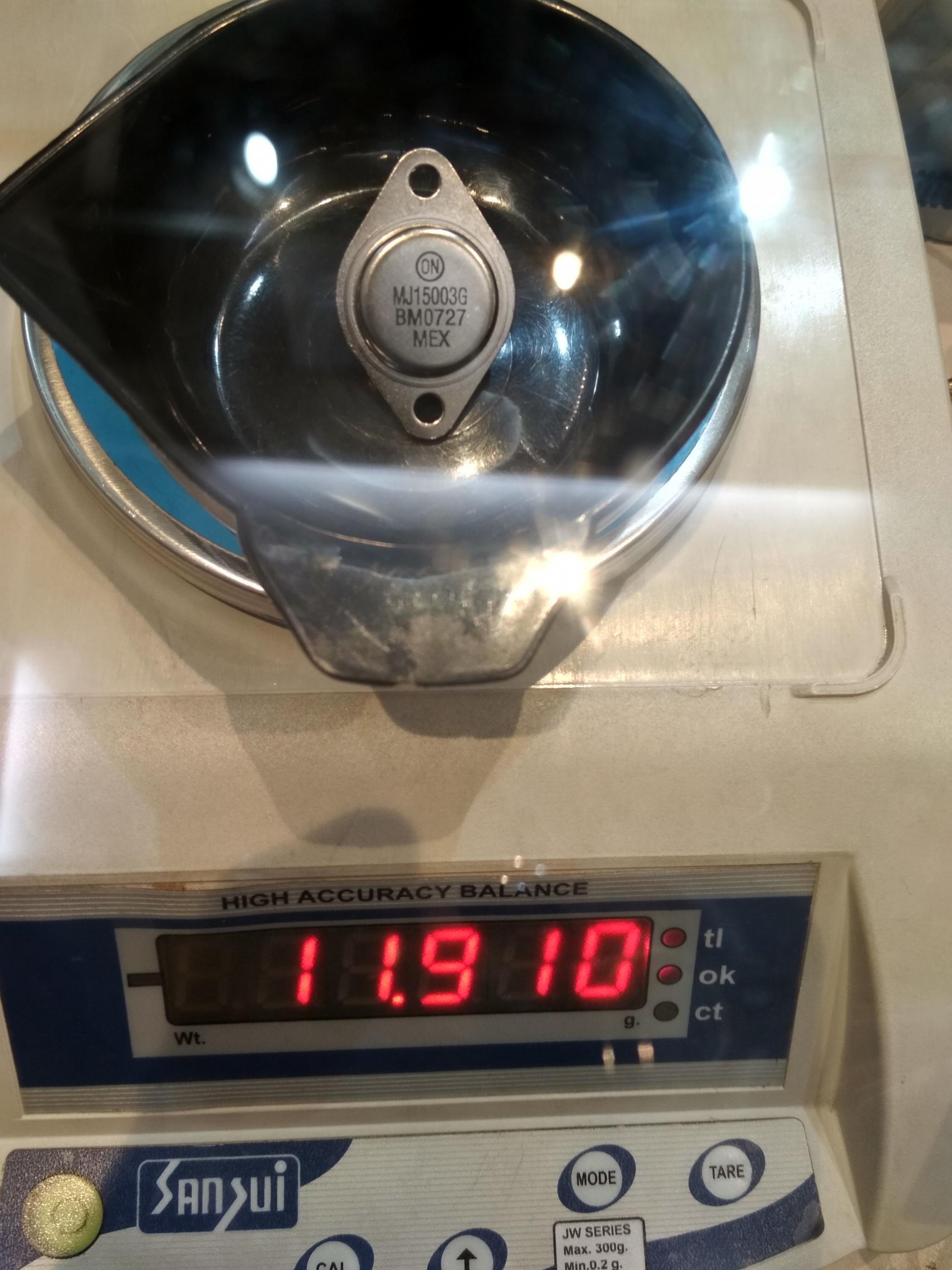

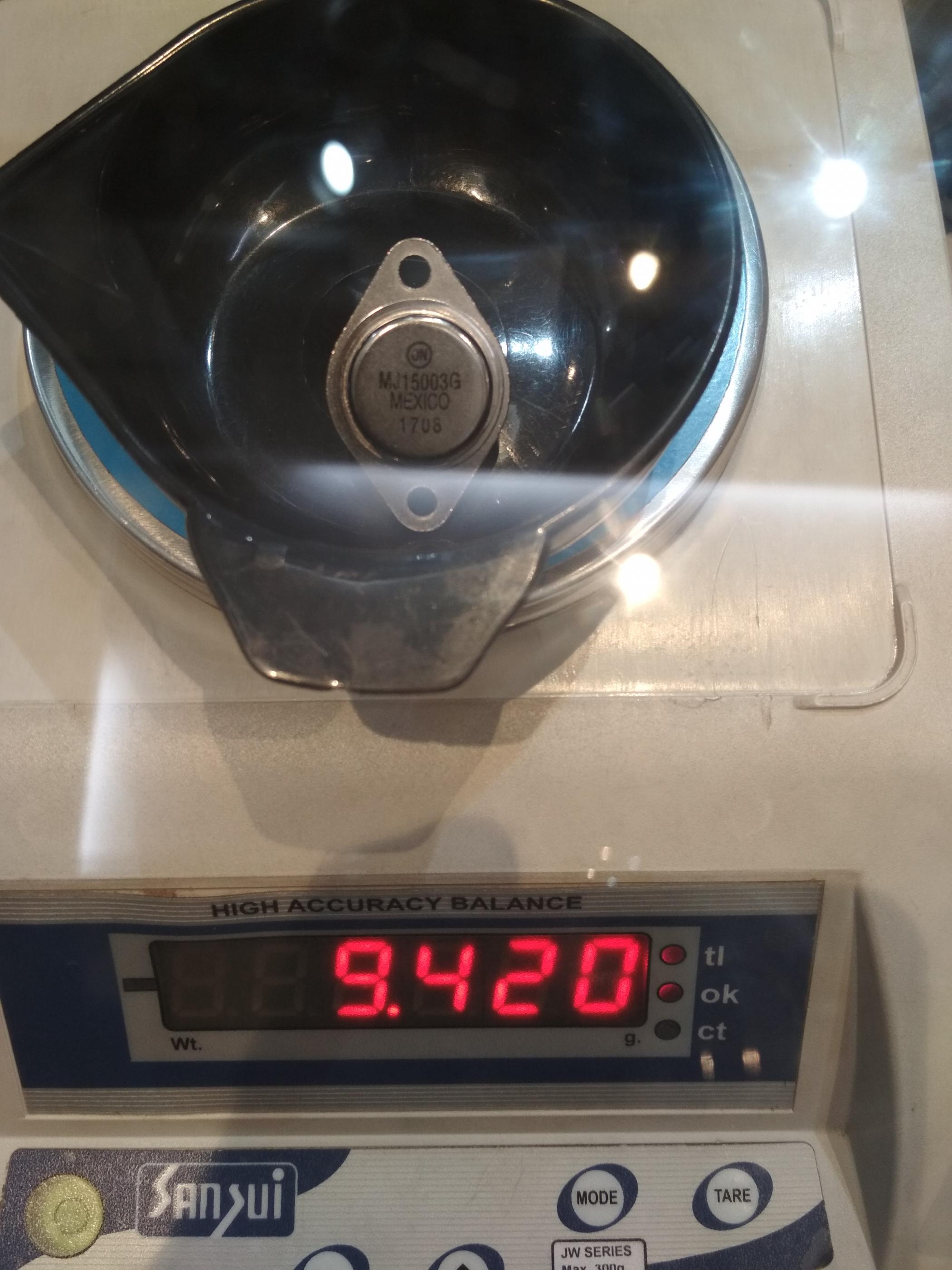

I have checked all the transistors they sent me, the 200 transistors labelled ON Semiconductor and the 20 labelled Motorola. I am afraid none of them are genuine. They are all a cheaper, lower specification TO3 transistor labelled as the high spec MJ15003 and MJ15004. I'll bet they have been taken from the rejects bin of a much lower spec transistor product run. As a quick check I found it is possible to tell a genuine one from a fake one by weight. On my cheap kitchen scales, the genuine one weighs about 12 grammes, a fake one weighs only about 10 grammes due to the lack of big heat spreader. This is no replacement for a proper voltage and power test though. I tested the power handling of the transistors using the rig pictured below. This set up dissipates about 30 Watts max and carries a max current of 8.5 Amps through the transistor. it runs off a 12 volt lead acid to get the Amps. An MJ15003/4 should stand 5 Amps at 50 Volts = 250 Watts when bolted to a good heatsink. The internal connection wires on the fakes are not big enough to carry the current let alone the silicon die. The transistors they supplied burnt out at about 18 Watts. The reverse breakdown voltage I tested was right on the rated limit of 140 Volts, a genuine MJ15003/4 would stand much more than that for a good safety margin.
