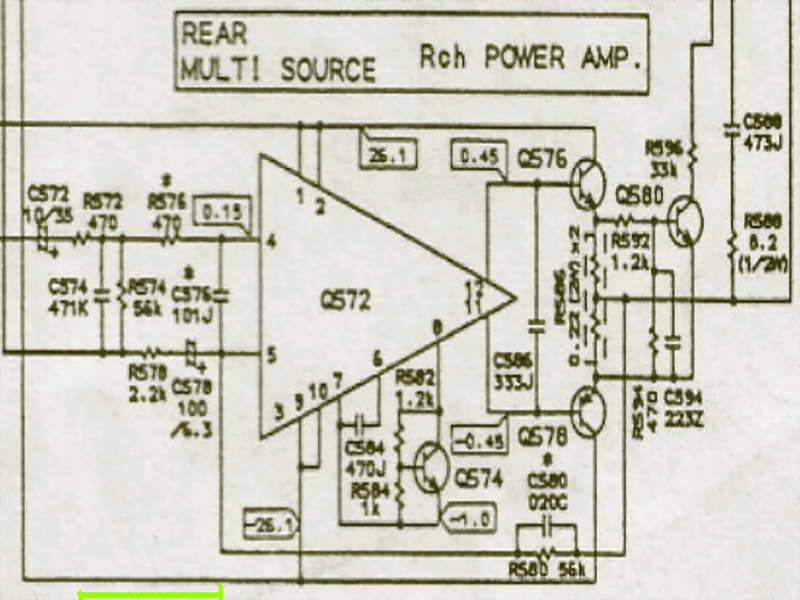

The power amplifiers, front and Surround units i will post them here.

Saving the image, you will see the chip model.
