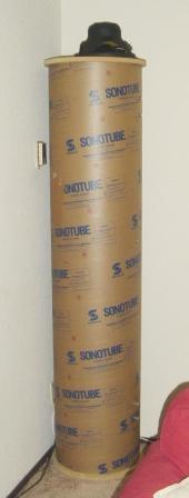

I just put the finishing touches on my sub project and wanted to share and get some feedback.
It's a "folded" TL design, using a 12" sonotube nested concentrically (well, eccentrially, I suppose) inside a 16" sonotube. There's a 4 1/4" gap at the bottom of the smaller tube, which makes the "bend".
I had initially wanted to use 14" and 20" tubes, since the CSA's of both sections are nearly identical this way, but found that these sizes are uncommon and hard to find (and really big). I was skeptical of having the area of the first and second sections of the line differ, but after modeling the line in MJK's Tl Sections sheet, I found that the response actually looks quite good, with a broad flat fundamental peak from around 22 Hz to 65 Hz.
The design is intended for the Ascendant Audio Atlas 12, which I don't have yet, so sitting in for it now is my old Phoenix Gold car sub, which has a higher Q but nearly the same Fs and Vas specs.
So far, I'm quite stunned with the performance, especially considering the low cost. Bass is clean, powerful, and smooth, and extension in my relatively small listening room seems limitless!
The whole thing stands about 75" high; line length is 147".

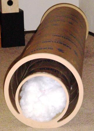

Here's a shot looking down the line from the top. The first half of the line is stuffed with about .5 lb / ft^3 of Dacron fill. I cut and wedged some 5/16" hardwood dowels sideways across the tube to keep the density even and prevent the fluff from all settling to the bottom.

What sizes of tubes are you considering? I'd recommend the heavy-walled versions if you can get them, as mine is a bit more flexy than I'd like... no rattles or offensive resonances, you can just feel quite a bit by putting your hand on it.

You might be able to make your sub much stiffer by bisecting or trisecting the outer tube with a couple boards and glueing/nailing/poswting/screwing them on each side to the tube face.
Meh, it doesn't really bother me that much. I don't think the vibration is caused by pressure in the line, it's more the mechanical motion of the driver making the inner tube want to oscillate around the point where it's joined to the outer wall at the top.
I may get inventive and try to knock a wedge-shaped block under the edge of the small tube in the bend, bracing it against the floor. Have to find a way to do this on the end of a 7-foot pole, though! 🙂

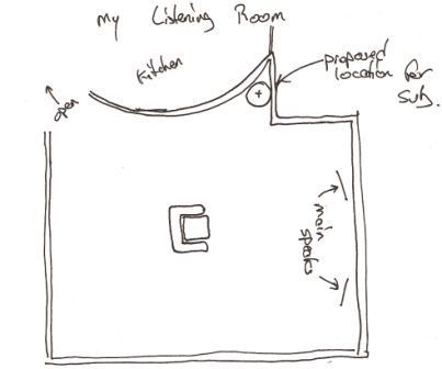

Alright, for those that care.....here is my goofy shaped room. As you can see, there is a hair pin corner that is essentially useless and is where my flatscreen goes....there is still a good 20 square feet back there.
