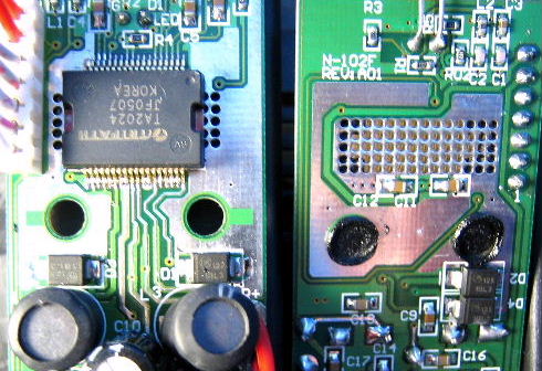

Just started tearing into my latest shipment of T-amps and found that the first two I liberated from the cases had a strange look to them. It is the look of no lumpy solder flowed on the boards. Its been understood that this was for heatsinking, and so its either been deemed unneccessary or its a manufacturing oversight.
Anyone else seen this on newly acquired boards? Mine are from PE.

I just looked to see if I could attach one but the chip actually floats above the board. The perforated holes need to be filled with solder until they contact the bottom of the chip. Can a solder bridge be built from the little metal taps that protude from the sides of the chip, w/o damaging something?

This can't be good. The Tripath docs call for the solder slug for cooling. Obviously the PCB is made for it. Even with the slug, the chip gets to hot to hold.
There must have been a slip up in the factory. Odd that the boards got all the way thru the assembly like that.

I have a slugless version too.
S/N: AIV0502003068.
This is not good.
The chip needs the cooling.

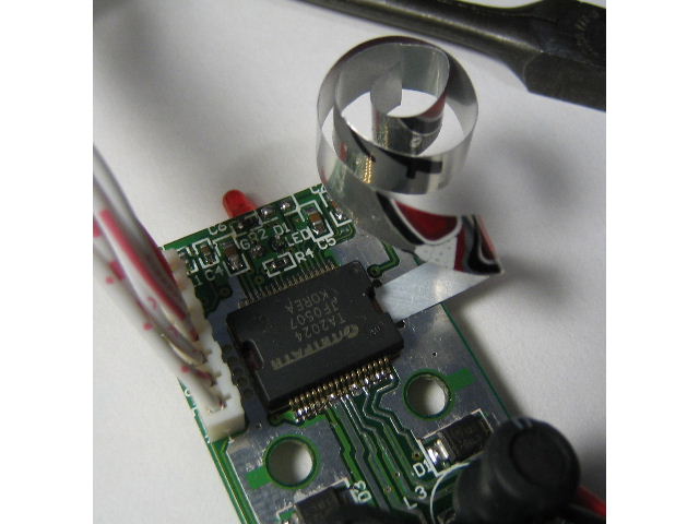

I took a good look at the chip and its raised off the board just enough so that I could slip a piece of aluminum under it.
Dont laugh, but maybe this could be a solution of sorts. I will give it a try tonight and see what happens. Its a strip of a coke can and it fits tightly between the bottom of the chip and the board.
amt

amt, i laughed but also think that's a pretty clever idea! that's "junkyard engineering" at its finest 😉

OK, so what are D1, D2, D3, and D4? I don't have those on my board. Are they necessary for good sonics/ proper funtioning? On my (I believe) version 2 board, those areas are covered with the solder slug.

Diodes
Tripath lists them as needed. The early SI's did not have them. The pupose is to prevent back emf coming back from the speaker. This CAN drive the output to below zero.
There are lots of SI out there without them. Never heard that just playing music blew one up. Usually it is hooking up a new power supply, or a modifing the circuit boards. Lots have gone up in smoke after being modified.
