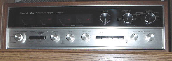

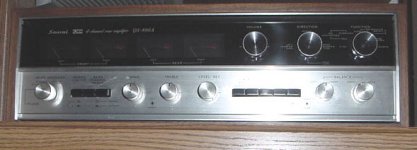

Get a load of this little item😛
It's a Sansui QS-800A
I also have the "Operating Instructions & Service Manual", complete with schematics and parts lists.:nod:
It's about 30 pages.
Anyone Interested?

Man, I used to fix those Sansoupis back in the early 70's! Worked at a hi-fi service center for a large chicago Hi-Fi store chain back then. Those darn plastic tab power output transistors used to literally melt apart! Some of the more expensive models had TO-3 style outputs. Then came along the Pioneer SA-1000(er somethin like that) receiver at 250 wpc! Wouldn't even fit on my bench! The Pig of all Pigs.....

That might ahve been SX-1000 Pioneer. I think thats how much it cost too.
The Sansui QS-800 could play the 4 main types of quad that was available back in the 70's. It is a quad extension to a receiver or integrated amp.
It has what Sansui calls QS Vario-Matrix which can synthesize 4channel from stereo, decode both Sansui's QS Matrix encoding and CBS's SQ Quad encoding. Plus it has four 45W amps for discrete quad (discrete material was only available on 8 track tape and reel-to-reel). QS or SQ encoded quad was available on disc or FM broadcast.
I use it now for my computer amp.
