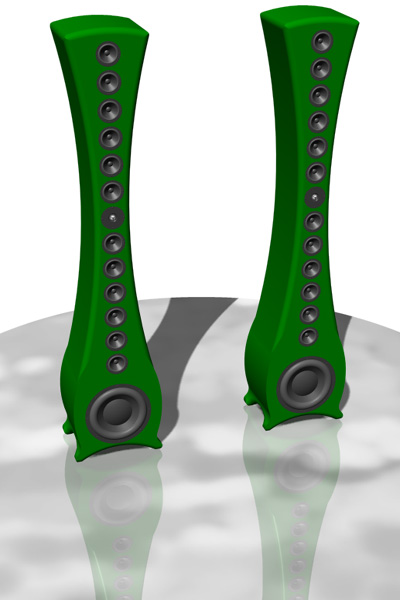

height = 2m
drivers at initial stage, per side...
10 x Vifa P11WH 3,2,2,3 taper 4.8ohm... open back at present !!
1 tweeter: currently using a pair of KEF T15's, of dubious origin, slightly horn loaded. I don't think they have quite enough sensitivity, but not too bad considering cost ;-) !. Tweeter baffle removable with maybe Peerless horn tweeter in mind when funding available !
1 Eminence Gamma 12 in 65L sealed (may be vented later to pi-align type, 40Hz tuned, if insufficient bass)
cross-over... undefined as yet, been doing the cabinets...big coils for 3-way arriving in next day or so!!
Hopefully pics on Thursday evening US time !!
