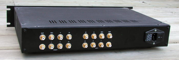

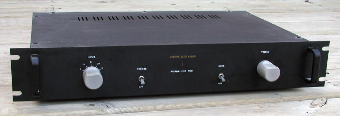

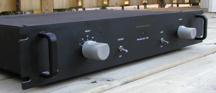

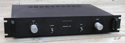

Since I've been accused on more than one occasion of showing creations that might be out of reach for some members of this forum I present here something that can be easily and cheaply done and looking nice as well.😉 This is BOZ I built for my brother in law.

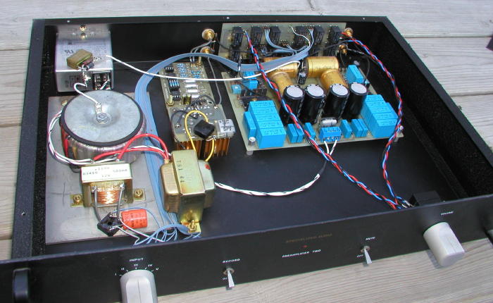

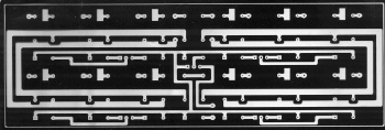

The PCBs were done and designed by me. I always prefer to use relay switching mounted directly on input and output connectors, minimum wiring this way and purer signal paths. I used separate transformer for relays. Input potentiometer is 100K Nobel sourced from Sonic Frontiers. The toroid is mounted on a thick copper plate.

It is true that it's looks good on the outside and as I said before it cost me around CAD 40 for case, knobs and switches. Good combination of colors and thought out placement of controls is a ticket to beauty😉 . I call it "on a shoestring", because normally I would use 1/4" aluminum instead of thin sheet metal, 2 separate toroids, more caps in PS and true mono layout.
But this one sounds really good too.

Your "shoestring" BOZ looks really good, but your comments brought a couple of questions to mind... well, maybe more than a couple.
What is the purpose of the thick copper plate the transformer is mounted to?
I'm starting to gather parts for a BoSoZ, and I'm interested in your use of relays for signal switching. Any recommendations from relays you've tried?
