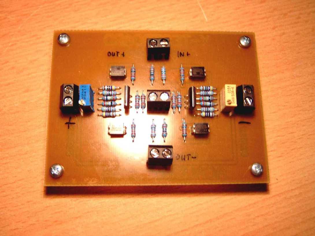

Once upon a time I thought I had the UGS figured out and was going try building a proto. NP has very graciously dumped lots of breadcrumbs on this particular trail. From info he had given plus photos on the Pass Labs site it appeared that the UGS was a JFET/MOSFET implementation of Fig. 2 of patent 5,376,899. However, one post by on 11/20/03 put the kibosh on that.

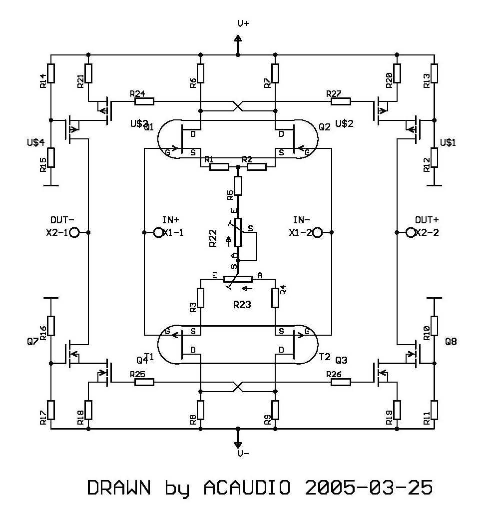

Ok Guys,
here is it:
It´s alive!
That's even more cruel that saying nothing 😛
be patient 😉
I had an idea and drawn this circuit. It is based a little on answers and publications from Mr.Pass and publications from Mr.Borbely in Audio Electronics (The new frontiers-> Basis knowledge to JFETs) .
I mailed this to Mr.Pass with ask for publishing-permission (Thank you Mr.Pass).
He answered Passlabs use only a single set of secondary mosfets, so I have simplified this. External components are not drawn. Actually schematic coming soon. (I play at present a little with the values)
Please excuse my very poor english.
Best wishes
Adam
Did you draw the schematic this way in order to explicitely show an "X"? 😀
PS: your english is ganz gut
Bricolo said:Did you draw the schematic this way in order to explicitely show an "X"? 😀
I like "X" 😀
In the figure of feedback (next update) is this so simply to draw.
/Adam

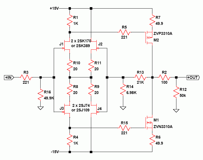

Interesting...
...as I also had Pass (Zen V5 for the second stage and the Susy patent for input) and some Borbely articles in mind for this....
NB-Don't rely on the values, and I think that some compensation caps would be needed. It's just the topology I want to show...don't know if it will work, still buying (=looking for
) the components...
Later, Tino
Later, Tino

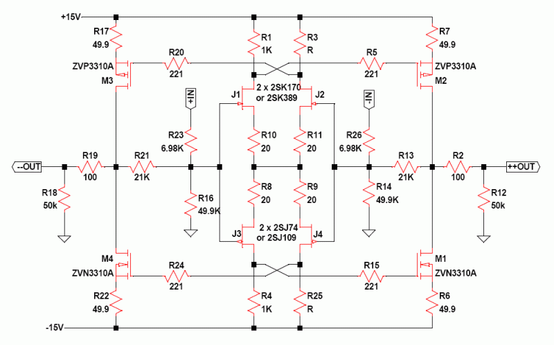

As I saw Acaudio's Board.....
.....I thought this would be the natural evolution of the circuit above 😀
But now you overtook me in posting the schematic, and yours seems to be quite more refined...
Am I wrong or can I see some John Curl elements in the input stage?
Well, I attach my proposal of the balanced thing....
Ciao, Tino
Ciao, Tino
Re: Interesting...
It looks very similar,I think, it will work, my works already.
adam
zinsula said:...as I also had Pass (Zen V5 for the second stage and the Susy patent for input) and some Borbely articles in mind for this....
NB-Don't rely on the values, and I think that some compensation caps would be needed. It's just the topology I want to show...don't know if it will work, still buying (=looking for) the components...
Later, Tino
adam
Outstanding work gentlemen. Thank you for posting. This looks like it could turn into a great thread.
ACAUDIO: It looks like your schematic has twice as many MOSFETS as the PCB. Is this what you meant by "Passlabs use only a single set of secondary mosfets"?
GL

Shouldn't the JFETs be cascoded - I thought I read this in a post from Nelson Pass (would also similar to the Borbely design) ?

I was "dreaming" of stuffing the non balanced circuit on a very compact PCB without input and feedback resistors, just as an op amp replacement.... 😎
But this balanced thing is also quite interesting. Nelson mentioned not too long ago, that the susy principle will work best with low feedback ratios. What is low? < 20dB, or even less?
I believe that my circuits will have at least 60dB open loop gain (don't know yet), so for 10 dB gain we have a loop gain of 50 dB. Too much?
Well, I'll have to go sleep now...
MRupp said:Shouldn't the JFETs be cascoded - I thought I read this in a post from Nelson Pass (would also similar to the Borbely design) ?
It depends, with source degeneration, not too much gain in the first stage and not too high input impedance, I don't think that it is an issue. But only listening will tell.....
Oh, yes, if we would like higher rails, then cascoding is a must. J-fets cannot take high voltage around them.
