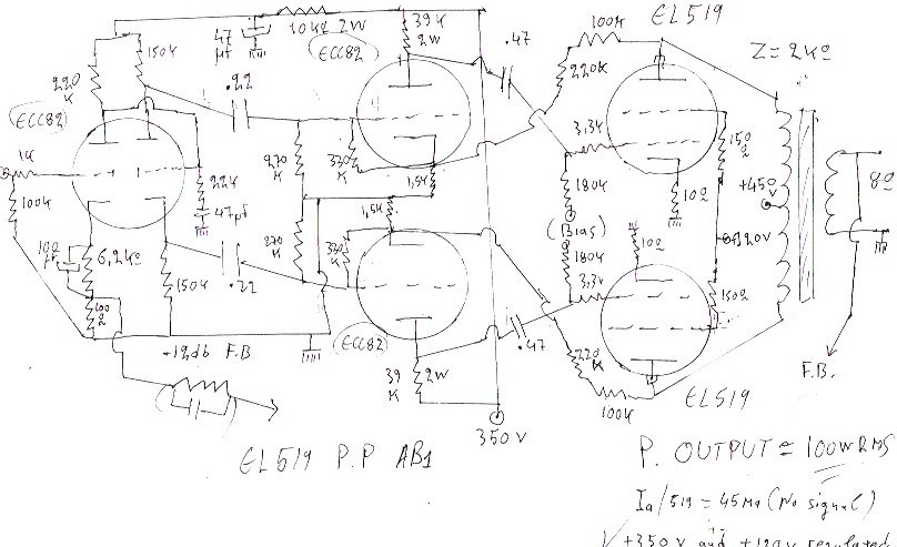

I have another schematic for PL509, which give 120W, with HT=400V, and Vg2=200V, I don't know the Raa, but I can check it.
sajti
Dear Fuling!
I've got a PL509 PP amp. (monoblock)
It called "APX-100", and manufactured in Hungary, by BEAG, in 1975. It was produced to feed 100V audio lines. So I rewinded the output transformer. Now it can deliver 120W-RMS into 8ohm. (before it delivered 100W to 100ohm).
The geniune tubes were two ECC808 (=ECC83), and a pair of PL509.
When I modified it to 8ohms output, I changed the driver tube to ECC82.
The anode voltage (for the output tubes) is 460V, G2 voltage is 410V.
The primary impedance of the output trafo is 2,5Kohm.
In the evening I will make some fotographs of the amp, and I will attach the schematic, if you are interested.
Otherwise the amp is a really oversized! It has a huge box (400*330*180), and huge trafos. The weight is about 20Kgs. After 30years it still in perfect condition. It was working only 60 hours... The output and the first tubes are still the geniune tubes... They were inserted 30 years ago in the factory...
Other datas: freq. response: 30Hz-15KHz (+/-1dB), input: 0,775mV (0dBm), 0,22Mohm
power consumption: 320VA, signal/noise: better then 60dB

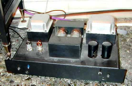

el 519
This is my amplifier , i have built 9 years ago and still working with the same output tubes [ soviet el519 ]:smash:
