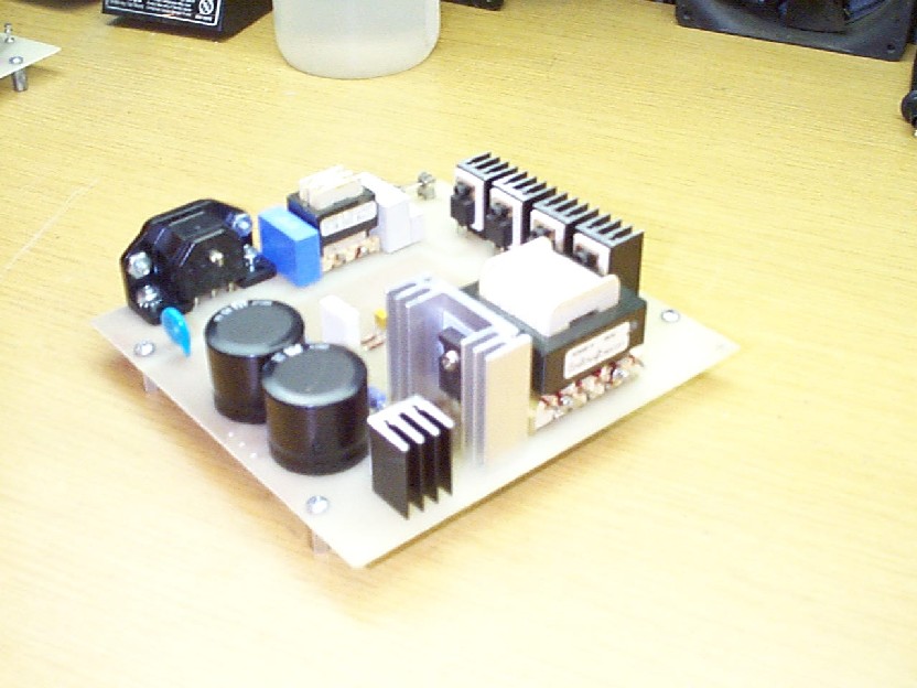

PFC Pic
Here's the PFC Pic I promised.....
Hi Steve!
In fact I was not aware that we really have a PSU sub forum.
....well....
Thanks for the link.
Really nice set up your SMPS. Do you really always make a PCB? Even you will only built one or two samples?
I am becoming a fan of 3D-P2P (3 Dimensional Pin to Pin) set up.
3D-P2P offers best opportunities for short wires, small loops, heat disappation & low parasitic effects, - if well done.
Your MC33262 / MC34262 is exactly the ON-Semi version of the L6562, which I had proposed... The most traditional and reliable way for critical conduction / transition mode PFC boost, I guess 🙂
FAN4822 is a nice variation for optimized softswitching. But it does not overcome the turn OFF losses of the switch.
The turn ON is already nearly perfect in a proper designed MC33262 / MC34262 / L6562 design. After demagnetization of the choke, the voltage at the drain of the switch is not only jumping to the value of the input voltage, but due to unavoidable capacitances there is a resonant down sloping and you can manage to turn on the switch
at nearly perfect ZVS and ZCS (both !) during most of the time of the AC mains wave. Only when the mains is close to max. (theoretical condition: Udcrail vs. ACmains < ACmains vs. ground)
During that times the down sloping will not come down to ground
and the switch will be turned on without ZVS. ZCS is still vaild, except charge for parasitic capacitances. I practice I observed that the turn ON losses are neglectible compared to the turn OFF losses.
Turn off losses can be optimized by fast turn OFF ( but take care for EMI ! ). A snubber cap across the switch can help here, but must be taken into consideration when turning the switch ON.......
FAN4822 could provide perfect turn ON soft switching during the entire AC cycle. But in my application this small advantage, will not justify 3 additional power components. Especially as it does not overcome the issues with the turn OFF losses.

Discontinuous-mode boost PFC converters are only practical at low power levels since at high powers it involves very high peak currents that cause high copper and switch loses and require a huge EMI filter to isolate the mains line from the high dI/dt of the inductor
For >1KW I would recommend continuous mode since turn-on losses may be reduced to a minimum by means of magnetic non-disipative snubbers
Also ZVS and ZCS are not practical at high power levels since they require extra power switches and inductors and they impose limitations on maximum duty cycle, causing poor current rise slope after zero crossing
This is my prototype, it uses a L4981A control IC from ST working at 45Khz to reduce switching losses. It also contains : Additional components to achieve consistent current limiting without entering chaos-mode, boosted CT discharge to achieve nearly 100% duty cycle [this dramatically reduces THD near zero crossing], buffered gate drive in order to avoid blowing the control IC everytime I blow an IGBT, a potentiometer for fine output voltaje adjustment and a jumper to select between 230V and 450V output [230V is safer for testing new features]
The input diode bridge is placed in an external heatsink and the EMI filter is not shown. I've successfully tested it up to 1.7KW continuous with proper cooling at 450V output and 160V AC input, however the board has space for additional components in order to get up to 4KW theoretical maximum output. Currently I'm using SKP20N60 IGBTs and MUR860 diodes combined with a coupled inductor that works as a magnetic snubber and contols the dI/dt at turn-on [and also at turn-off as a side effect]
Total output capacitance is 990uF 500V, quite high to reduce ripple voltage. The boost inductor is wound on a E65 core with 2mm gap, measures approx. 390uH and starts saturating at approx. 19A [I have no datasheets for the core]
The project has been frozen for months since I can't afford bigger isolation transformers to test above 1.7KW and I'd have also to buy additional electric heaters to dissipate such a high power
Some pictures :
Note that the control circuit is mounted on a breadboard to allow for further experimentation, only the critical switching sections are on the PCB
This image shows the magnetic snubber in detail, it's just a coupled gapped inductor that stores energy during turn-on and returns that energy to the output capacitors after turn-off. Primary inductance measures aprox 10uH and it saturares above 30A. It's designed to get 45A/us turn-on slope for 450V output. Primary to secondary turn-ratio is 1:3 [the secondary-side rectifiers have to withstand >1500V during switch turn-on so four MUR460 are used in series]. This could be called soft-switching
