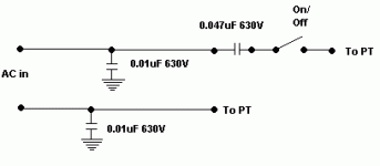

SY said:I seriously doubt that the mains has a series cap. A shunt, maybe. Double-check your circuit tracing. Make sure that you use a three-wire mains cord with the ground lead firmly connected to the chassis. Safety!
No No I'm sure. I'll attach a schematic... I obviusly will delete all that stuff and put a double-pole switch, just after the fuse, and ground.
Thank you!

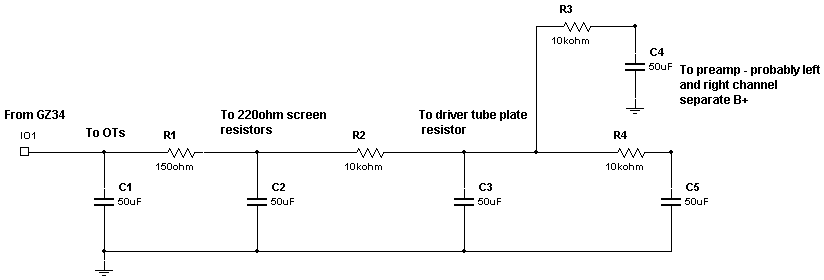

Mmmmm... I have desoldered the filter caps, and I noticed there's no negative lugs on them. Are they supposed to be connected to ground throught the chassis? Do I have to keep this or I must connect to the chassis with a wire? Is there any improvement in increasing the capacity (obviusly not the first capacitor since more will blow the rectifier)? I'll attach a schematic...

- Pwr supply caps: I removed them and opened the metal cans. One of them (to my surprise not the one who supply heavy currents in the EL84 plates) looks like it has overheaten, and some red 😕 gook has invaded the can... I just feel too afraid of dismateling them, I thought there was the possibility of them containing something toxic, and I put them in a sealed bag waiting for proprer disposal. I recycled the plastic insulators and I decided to connect the grounds of the new caps with a wire bolted on a chassis screw, like a safety ground one. The original caps made ground contact throught their metal can, directly to the chassis. This is destroying the star ground system! I bet that at Perser they know what they did...
- I removed the cathode bypass caps at the EL84 cathodes (one for each couple of EL84, 100uF 25V) and those on the driver tube cathodes (25uF 30V). I think to replace them, since a leak on them would cause the EL84 or the ECC82 to be unable to obtain proper bias.
- I will replace the 120ohm 8W (strange unusual power rating) that goes between the GZ34 cathode and the caps, it looks overheated. And also there is a 220ohm screen resistor to the EL84 that looks like it has exploded (really!), will change that too. Btw 220ohm would be too low for modern EL84s? Do I have to raise it to maybe 470ohm or 1k? I don't know the B+ voltage (that would give us some clues) but the pwr supply caps are rated at 350V... If it's really class A I would bet for around 230/250V at the caps, since it is the maximum for EL84 to be biased in class A. Any higher would automatically be class AB to avoid exceeding plates max Pd. I bet for about 310/320V...
I hope for class AB, so my tubes will last longer and my speakers would have something to work with... they're old-time AR18s... normal sensitivity.
I'll give news when I'll buy the parts I need...

Know very little about amps , but a few days ago I red about old fender guitar amps that use a condenser on the power line ( ground reverse switch) , this may answer Giaime question;
So to check the perser first put a lamp in serie to the power cord , then take off the rectifier tube and check the transformers ? but I don't have a schematic for the circuit so to know if the transformers are working I should check the tubes data and see if voltage is in the correct range ? Which capacitors would be better increased in capacitance to improve the performance of the amplifier ?
