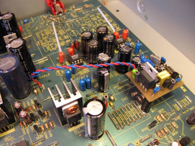

Hi guys!
Thanks rowemeister, I have nothing to add to the above!
You will find the sound without HDAM more open and transparent.
It's one of the well-known veils that will be removed ;-)
A dedicated clock with proper PSU indeed works very well (another veil) ;-)
Ray.
Ahha, nice pic, and yes I entirely agree - a clock (only with fresh psu tho) transforms the player.
Might I humbly suggest you try OPA627bp on daughter-boards, as it looks like you're using OPA2132/4 or something (can't quite make it out). And 627 pees all over them.
Thanks.
Thanks.

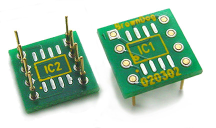

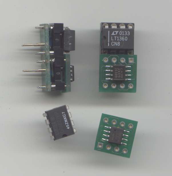

Hm, sharp vision you have... Don't worry, the 2134's are temporary, since this picture is made when the player was still on the workbench...
Ray.

6h5c said:
Here's a list of some opamps and their data. I tried most of them in my CD67. The ones with some form of comment in the Pref. column are favorites. The data helps me to establish a relation between the numbers and the fact that a certain type sounds good.
Ray.
Interesting, thanks for sharing. I see the 627bp is there ;-)
But not LM6172, Thorstoen's favourite when he modded this player. I bought this one to try but since 627bp was so mindblowingly good I didn't bother trying. I actually use LM6172 in my preamp, which gives a detailed heavyweight solid sound.
