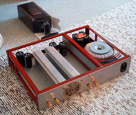

My Crescendo amp pics
Couple of questions still open...
Number of the fuses:
a: Do I have put only one to the primary side?
b: Or also two fuses to secondary side? And where should these two fuses to be placed. Before rectifier or after rectifier or after capacitors?
Earthing:
a: Do I have connect the earth ( from wall socket ) merely to amplifier metal case? So speaker terminals and RCAs are isolated from case. And power supply zero point ( center point of PSU filter capasitors ) is separate from this earth.
b: Or do I have connect earth ( from wall socket ) to power supply zero point ( center point of capasitors ) and from there to metal case? And still keep speaker terminals and RCAs isolated from case. Or how I must do it?
Hi Eccu,
looks nice!
You only need a fuse on the primary side. The original Crescendo had two extra fuses in the plus and minus feeds placed on the circuit boards.
Connect all of your grounds to one central point and from here with a resistor or NTC to the chassis. Connect chassis to wall socket (earth😉)
In some cases you must disconnect the input ground from the central point to avoid humm (it will still be connected through the 10ohms resistor)
william
P.S. Don´t you think you caps will smell when they get warm?
