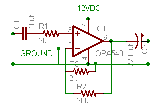

I want to build a single supply opa549 to run off of 12VDC.
I tried using the schematic provided by TI for single supply operation of any opamp, but when turned on, I got instant, unbearable distortion at any volume level. I thoguht it was from running at only 12V, but I tried 40V and got the same problem.
Does anybody know how to make these things run off a single supply?

yep... even input.
At first I forgot to, but there was no DC output. When I added it, nothing happened.
Was it right to tie the Ref and the other pin (can't remember it's name) that normally ties to ground to the negative supply pin, which is connected to ground, along with the signal and speaker ground?
Can you show us the schematic?
Do the inputs float at half the supply voltage?

EDIT: To your last question, no it was not right.
+U is connected to positve supply pin and ground to the negative.

That schematic doesn't work. It's the one I built that does not work.
Almost forgot, I also tied the Ref and I/LM to ground, as they would be in a normal split supply circuit.

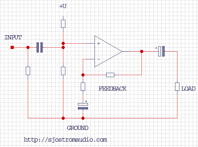

Use a voltage divider on the input of the op-amp to bias the + input to 1/2 the supply rail.
Otherwise you will only get half the audio signal out!
When the input is connected like peranders suggestion it will work, but it is vital to have input and output DC blocking caps or you will fry your source and your speaker! 😱
Use resistors of 1K to 10K or so (even higher would work, just remember the two resistors you use must be the same value.

And by the way this will barely make any power at all, 2W or so into 8 ohms at 12VDC.
At 26VDC you would hardly have enough for a sub amp at 9W or so into 8 ohms.

With peranders circuit, I also connect 12VDC to the power pins not just where it shows right?
And I still don't know what to do with those ref and I/lm pins

You´d connect it also to V+;With peranders circuit, I also connect 12VDC to the power pins not just where it shows right?
ground will be connected to V-
The rest as per P-A´s schematic.
