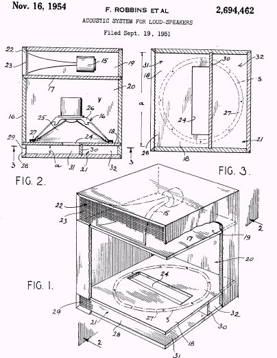

I'm getting fascinated with this not so common loudspeaker load. The only documentation I found about this cabinet is the original patent by Frank Robbins and William Josep (the R-J of the name, I guess).
What about the design rule and formulas that applies to this cabinet? Is it a simple bass reflex in another form or is radically different? After radiotron there shoul be a fundamental paper in Audio Engineering 27.1 Jan 1953, by the same authors dealing with practical aspect of this load. Anybody has this paper and can shere it with us?
Somebody has experience with RJ loudspeaker?

It's a type 2 bandpass so is quite common in car subs, etc., apps. LspCad (and I assume there are other programs) can accurately sim these with much more flexibility than the original simplistic formulas allow. Note that they are simplified Karlson designs and their patent is after his, so one has to wonder if they were just trying to capitalize on his work.
Like Karlsons, for wide BW use some experimentation is required to find the right amount of trade-off between gain and BW, with the K-slot being a better performer overall than those suggested in the patent, though of course they couldn't use it at the time.

First off, AFAIK the Supravox cab is not an R-J concept, at least not any listed in their patent or any actual cab with their logo on it that I've seen, but an aperiodically loaded reflex suitable for damping high Q systems. Big difference.
That said, the R-J uses a small enough front chamber/exit slot to damp the impedance peak well enough to be considered aperiodic in nature, though not a 'pure' aperiodic unless additional resistive vent damping is used in the form of stuffing or as was done via dense grill cloth on at least one of their models.
Sounds like you're letting the Karlson's multi-stage reflex loading and other folk's erroneous assertion that it has any TL properties 'blind' you to the fact that it is basically a reflex loaded bandpass. A simpler solution is to substitute all those reflex chambers with a single reverse tapered TL.
No, it is not a synonym for 'bandpass'. 'Bandpass' means that it only allows the driver to reproduce a limited BW of 'x' octaves, like a horn's compression driver.
Maybe the typical USA car audio 'sub' boxes are not popular in your locale or you do not 'see' that the R-J is no different in concept than today's typical BP cab design consisting of a ducted port vented cab terminated into another ducted port chamber.

Correct TTBOMK! Indeed, if you look in Cohen's 1956 book, the Supravox is a variant style of reflex defined as a Helmholtz Resonator to differentiate it from the typical cutout-in-baffle vent style reflex.
The original 'HR' layout has the driver mounted on the rear of the baffle board which in turn is mounted to the inside of the cab cutout. Done this way, it's simple to calc the effective vent area/length.
Accurately calcing the Supravox variant will be problematic since the driver is acting as a phase plug of sorts, but you can use a box program to find the cab's Vb and basic vent dims. Still, the layout allows relatively easy adjustability by altering the gap so I would make the baffle some high percentage in area to the cab face and try different air gaps, starting with a swept area = whatever the box program predicts for a short, low mach vent. Adjusting the gap can easily be done using 'T'-nuts and long bolts, then replacing them with something more rigid/cosmetic once you're satisfied with the performance.
GM
If it's that box with damping material inside and opened on the baffle sides, it seems that you can just design the box size as a closed box and make the baffle height adjustable. The height can be such that the maximum opening area is not larger than Sd, then you can reduce the opening until you get the desired response. This kind of seem to be variable since there is more friction because air is moving in and out through the same port but in opposite directions. Look at how the impedance plot varies when you adjust the opening size, and you will get the hang of it.
Here's a fragment of the patent 2694462 filed in 1951

Yes, the reason I had not heard of the design is that it does not work as a full range speaker. There is a hole in the response from about 100 to 500Hz because you only get the port output.
It is perhaps the first subwoofer design though, the patent having a good description of how to do the design.
The idea of mounting the woofer with a gap to its baffle is mentioned in the patent but this is not really what the patent is about, so modern designs with that only that feature should not be called RJ
Just read the supplement to the Radiotron designers handbook.
More on the RJ enclosure quote:
When the speaker is intended to handle a wide frequency range the central portion of the cone must not be obstructed by the frontal board.
The drive unit is mounted on a "speaker board" which is mounted a short distance behind the frontal board. By decreasing the spacing between these two board it is possible to lower the Q of the system.
It seems that Robbins and Joseph (RJ) realised the flaws of the original patented design and modified it.
