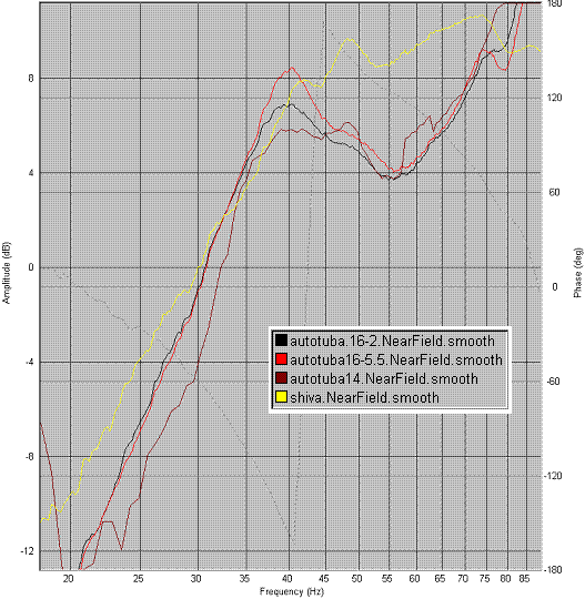

I've built two versions now of Bill Fitzmaurice's Autotuba design. This is a horn sub with a 7' path, using the MCM 55-2421 8" driver.
The first is the textbook one, with 14.5" outer dimensions. The second is slightly larger, with 16" outer dimensions. Although it doesn't sound like much, the difference in mouth area is significant.
I've attached nearfield measurements taken with Speaker workshop, smoothed 1/10 octave. Behringer ECM-8000 mike, with Claudio's calibration file. These measurements have been adjusted so that the SPL of the tuba and shiva match at 40Hz--this is not showing the absolute sensitivity.
The black and red lines are the 16" tuba--the only difference is the black has 2" legs, the red 5.5" legs.
The brown line is the 14" tuba. For comparison, the yellow line is an Adire Shiva in a sealed 75L box.
I'm interested in any critique of my measurement setup. I was unable to measure any loading differences, whether I located the sub hard in the corner, farther out, or in the middle of the room. Does the nearfield measurement remove the contribution such loading would normally impart?
The Shiva F3 appears to be textbook at ~38Hz, so I am inclined to think that these measurements are spot on.
It looks like the 16" version picks up a few dB over the 14" below 32Hz, and the Shiva definitely is a big winner below 30Hz.
This is only part of the story of course. I will try to post measurements tomorrow indicating relative efficiency, and max SPL at 40, 30, and 20Hz. I'll also include some subjective comments after I've had more time to listen...I don't want to overstate my initial impressions.

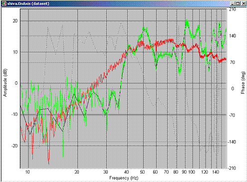

Sub measurements always seem to be hopelessly optimistic. Grey has been hammering on this for years...the TS equations work, but there is generally a 1st order highpass starting fairly high up that causes problems.
A suggestion was made to measure farfield near the ground plane. This measurement shows the nearfield, on-axis gated farfield, and ungated farfield measurements for Shiva. If room loading is being measured at all with this technique, it isn't helping much.

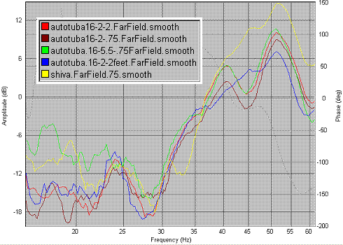

This graph shows the tuba at various distances from the wall, with 2" and 5.5" legs. There are some variations, but they are subtle for the most part.
I also include the reference Shiva. There were no significant response differences, no matter how far from the wall I moved it. So, it does show that the tuba has some sensitivity to loading.
None of these curves are scaled; that is, each curve is printed as measured, with equal voltage gain. Because the Shiva has much lower impedance, it is drawing anywhere from 2-4 times as much power for the same voltage. (3-6dB)

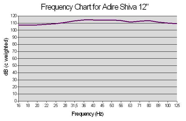

Shiva EBS measurements :
This is not a max SPL chart and this is in the center of a small room, not in the corner.
I don't know if she used the RatShack SPL correction chart on these numbers, I'll ask her.
16 107,5
18 107
20 107,5
22 108,5
25 109
28 111
31,5 113
36 114,5
40 114,5
45 114
50 114,5
56 113,5
63 111,5
71 112,5
80 113,5
89 111,5
100 110
125 109
simon5
Could you show you box on this post and tell me the specs of that box, eg how many litres, box dimension, port tuning watt driving the woofer and what shivs model.
because those numbers are unbeleivable:bigeyes: 16HZ at 107db that better then any subwoofer on the planet and its not even corner loaded
your box must be HUGE or somthing
juding from your success if i bought a tempest 15" could i beat those numbers (DB)
Greets!
It appears you've led a rather sheltered life WRT infrasonic BW output capability from a single driver. 😉 107 dB/16 Hz is rather ho-hum by today's high Xmax/power handling, low Fs driver standards.
