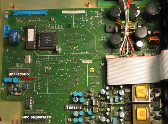

Trying to see if improvements can be made to a Studer D730. For instance I am wondering if clock signal could be improved.
Would anybody have the Studer D730 Service Manual?
The set of chips in the D730 are:
Xtal 11.2896 + Philips HEF4750UD (wondeing if this chips helps regarding jitter).
Digital filter: NPC SM5803APT
DAC: TDA1547
Analogue section: 7x 5532 🙁 and output trasformers.

I've found the TDA1547 very responsive to improvements in power supply. Almost every improvement to supply (eg. good film bypass cap, Ocson for digital supply cap, etc) is rewarded with improvement in sound. So my experience is that op2134 and lm6172 work well with the dac. Even with improved power supply for the opamps, the ne5532 just doesn't deliver the transparency available from the 1547 output.

Hi
The 4750 is a sampling phase comparator, which potentially works very good, but finally the jitter depends on the oscillator structure and power supply.
The 1547 reacts very positively on a real low jitter clock at the inputs pin 5 an pin 28.
Studer generally makes well designed equipment, not always most audiophile though
best regards
Indeed in general Studer products are well build. You can sse here if you are curious the Power/DAC/Analog board.
It seems that there are two paths possible to follow:
1) OP amp changes 5532 to AD825 or BB2134 or 2132. Probably best to add sockets to make trials.
2) Replacing crystal by higher quality low jitter clock. Would you have a recommendation or a schematic?
and third path would be caps upgrade, I am assuming though those would have less effect than first 2.
Thanks,
cd

Hi
I assume this player can also run at external wordclock (Hence the 4750). If you want to upgrade the clock, it is best to have schematics avalable as you may want to chose to exclude the external wordclock operation (simple upgrade).
There's 2 decent DIY clock solutions on the market that I am aware of, the Kwak clock and my own (TentLabs).
cheers
Thanks Guido.
Indeed it has a world clock input, but I don't understand how if unused it would affect the internal clock signal? Is the clock poluted by EMI?
I have not posted a reply in while because I am searching for the service manual (it has the schematics). I have not been able to find one at a reasonnable price yet.

Hi Cdfr
conserning analogue stages, have you thought about bypassing the on-chip I/V opamps ?
My understanding is that they resemble NE5532 types.
My idea is this (TDA1547 in CD950 philips) : see pdf.
First page 'resembles' the situation in my player now. (which I used to simulate)
Second page is my attempt to produce something simpler and hopefully audibly a lot better.
PSU changes are not included there.
Don't mind the current sources for the inputs, these are guessed on the basis of some measurements.
the only problem are the on-chip opamps which are internally connected to the outputs of the dac itself (cfr. datasheet)
Oh, and PSU upgrades indeed do matter a lot, as does guido's clock.
Any thoughts ?
