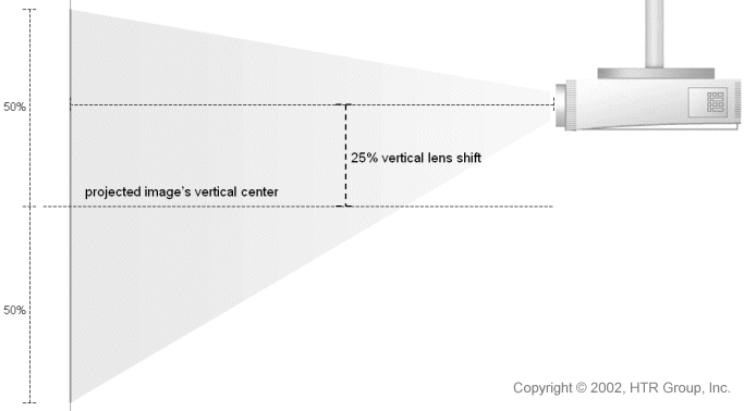

I've also been working on lens shift. BTW, tilting the fresnel is part of a lens shift design. Making it work properly in the DIY world is a bit of work.
Heya buddy, lens shift is totally different then what you are thinking, a frensel has nothing to do with it and it cant be acheived with frensels. Lens shift can only be acheived by using 2 offset wedge prisims at the back of the projection lens. Lens shift is offsetting the optical axis.
Trev 🙂
Tilting the fresnel is still an optical keystone correction method. But, I guess a 'true' lens shift is beyond what I can expect in DIY. However, if I tilt the fresnel, I am moving the optical center of axis from the the objective lens. To compensate, shoudln't I need to move the objective lens to properly align it again? I know doing so is not common in current designs, but this is the type of thing that I want to test first before I build my unit
Thats correct, but lens shift has nothing to do with keystoning. Lens shift alows you to have the projector flush with a table or roof and have the image coming out at the apropiate angle from the projection lens to the screen.
With a frensel the image only comes out strait, keystoned or not, with lens shift you can keep the projector where it is and move the image up, down, or side to side without having to ajust any keystone or moving the actual projector. Infact those projectors with lens shift dont have keystone as they dont need it. What they do need though is a wide angle projection lens.
No it dont move the axis at all, its just changing the focus of the top and bottom of the cone of light going into the back of the projection lens, its not moving the actual optical center axis like what lens shift does.
Lens shift is easy enough to do, its very diyable, all you need is 2 wedge prisims................. that arent so cheap.
