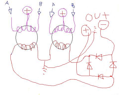

DC -DC DC-AC SMPS SUPER POWER
THIS HOLA IS MY TO THINK FOR 3 PHASES I FOR SYMMETRICAL, THESE ARE MY DESIGNS. YOU THEMSELVES THINK. WITH SG3525Y IRFZ44H
