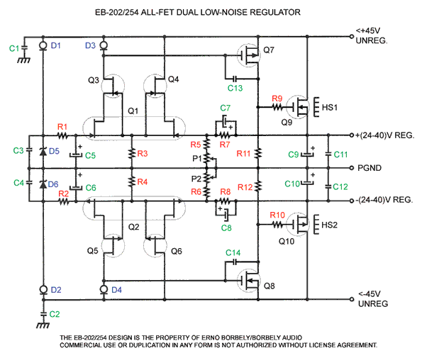

ok boys, lets have some examples of regulator topologies to see what we may be facing here. If we can accomodate the regulator on the same board then the extra hassle would be minimal and the advantages great.
The regulated power supply in figure 7 of the following Nelson Pass article is easily modifiable for this purpose by changing the zener diode values and the number of paralleled pass elements. The curcuit is simple and effective and has a low parts count. Why reinvent the wheel. Of course, because of the power required, a pretty good heat sink will be needed but that will be true of any linear power supply utilized with this amp. The other alternative is a SMPS which has other concearns.

Mikett,
I have never even considered total amp regulation. However, if it makes the huge improvement you claim, then it may well be worth it. Your claims do sound to be very conclusive. If it does not then I will be stuck with a transformer with higher rail voltage then I wish to use. Has anybody had similar observations? Could you post a schematic of your regulator and some pictures of your amp?
There aren’t to many schematics on line for total amp regulators, at these powers. I have found two possibilities. One is a circuit by Anthony Holton. He’s the one that built the really good sounding N-channel amp about a year ago, it was really popular. The only problem with it was it kept on exploding. It has good PSRR. However the circuit an only supply about 200 watts max, the schematic is almost unreadable, it’s not very well documented, and the parts are very difficult to pick up in the US. Here is a link:
http://www.aussieamplifiers.com/regulated.htm
The other option is a Pass regulator using mosfets for the power stage. It’s PSRR is not very good and the circuit has to be scaled up a little. But the circuit is so simple, that it is very easy to do. Right now it would be my preferred regulator. A schematic can be found at:
http://www.passdiy.com/projects/zenv3-6.htm

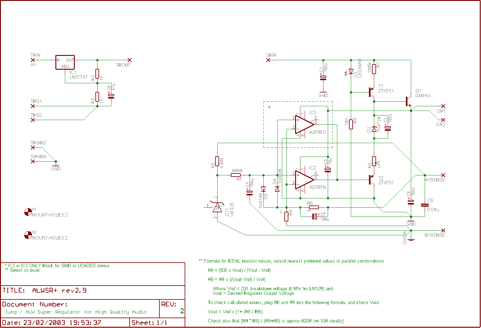

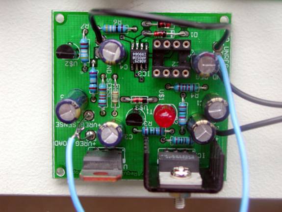

kilowattski said:The regulated power supply in figure 7 of the following Nelson Pass article is easily modifiable for this purpose by changing the zener diode values and the number of paralleled pass elements. The curcuit is simple and effective and has a low parts count. Why reinvent the wheel. Of course, because of the power required, a pretty good heat sink will be needed but that will be true of any linear power supply utilized with this amp. The other alternative is a SMPS which has other concearns.
Pass Active Supply Regulation
I've always thought that the power supply regulator of Mr. Pass is not suitable for this purpose.
If the current draw from the output of the regulator is not constant, the output voltage will also variate since the Vgs of the mosfet in the regulator will variate with the current through it.
For an amp that does not draw constant current from the PSU, I think what we need for regulating is a circuit with some feedback.

ALL-FET Dual low-noise regulator
2x+/-(24-40)V/200mA. Needs 2x(22-32)VAC
ONE 185.00 Euros
The EB-202/254 consists of two dual wide-band, low-noise regulators, using only FETs (JFETs and MOSFETs) as active elements. Maximum input voltage is ±45V and maximum output voltage is ±40V. Maximum output current with 5V input/output voltage difference is ±200mA.
The set-up procedure consists of adjusting the output voltage to the desired value. Connect 2x270 Ohm/5W resistors to the outputs and a DVM across one of the resistors. Connect the appropriate unregulated DC voltage to the regulator (should be approx. 5V higher than the expected output voltage) and check the output with the DVM. Adjust the output voltage to the desired value with trimpots P1/P2. If you have an oscilloscope and/or an audio µV meter, connect them across the load resistors and check the residual hum/noise. The scope should not show any ripple and the µV meter should show less then 5µV of noise over the audio bandwidth.
ONE 185.00 Euros
acenovelty,
The Walt Jung Super-Regulator may have potential, the Borbely doesn’t it’s basically the same as the Anthony Holton circuit, but with fets and no component values. The maximum output voltage on the Borbely is way to low, and it’s allot of money to pay. You’re pay more for the intellectual property then you are for the board.
At this point the Anthony Holton circuit seems to be the best candidate. As the Pass would need feedback added or many more devices to compensate for the high resistance. The way I understand the problem is that when the amp draws instantaneous current from the regulator the voltage it outputs sags / modulates. To compensate for this the regulator with feedback senses the drop and sends even more voltage through.
Does anyone have more information on the Walt Jung Super-Regulator, the schematic does not talk about max input voltage or max output amps.
Another working circuit can be seen at LCAudio’s web site in the articles section. The only problem again is that the voltage is to low.
