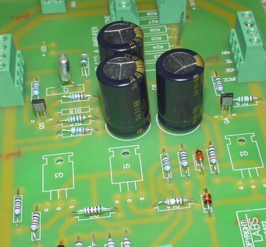

also, i'm using ztx450's, can someone look at the layout and make sure that they are the correct orientation? thanks!

In the pic, you are looking at the roundish side of the transistor w/ the ztx printed on it. The flat side doesn't have anything printed on it. Seems to me this is correct. Email me and i'll send you the real pic. 🙂
