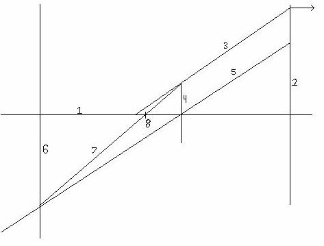

I just happen to have a drawing!
Pretty close, but you can't just subtract to get the answer. And you can't get anything within 20 mm of the center of a Ushio retrofit lamp's arc, because the T15 lamp (15/8") has a 23.8 mm radius! I have read posts that claim success with a 200 mm fl PCX with the flat side 1 to 2 mm from the lamp's outer envelope.
You have to do more than just move the lens toward the lamp until all of the fresnel's corner's are lit. The light has to enter the fresnel as if it was coming from the fresnel's focal length, if you want it to come out the other side parallel. (Of course, you may not want it parallel to adjust the fical point of the lamp arc image into the projection lens.)
If you do want it parallel, then you need to put the condensor lens at the position where it would perfectly intersect the cone of light going to the fresnel from a lamp at the focal distance. Then you need to move the lamp closer to the lens to compensate for the magnification. That should just light the corners of the fresnel.
Here is a graphical design you can use to make your own full-scale model. Substitute your own distances!
This example uses a 15" LCD, a 220 mm fl bottom fresnel, and a 100 mm diameter 200 mm fl condensor lens.
Start by drawing the central axis, line 1. (Make a full scale drawing.)
Draw the bottom fresnel, line 2. This is a 15 inch line, centered on the central axis.
We want the light to exit the right side of the fresnel toward the LCD perpendicular to the fresnel. (see arrow) For that to occur, draw line 3 from 7.5" up the fresnel, to a point on the axis that is 220 mm left of the fresnel. This is the path the light must follow to get refracted along the arrow at the top.
Now draw the 100 mm diameter condensor lens, line 4. Place it so it just intersects the required light path, line 3. At this point you can measure the distance between line 4 and line 2, the condensor-to-fresnel distance.
Now draw line 5, parallel to line 3, but through the center of the condensor lens. (Light that passes through the center of a lens is not refracted.)
Next draw line 6, 200 mm to the left of line 4. This is the focal plane of the condensor lens.
Since line 3 and line 5 are parallel on the right side of the lens, you can draw line 7 to the point where they focus on the left side of the lens. (This shows you how light traveling to the right along line 7 will be refracted to line 3.)
At point 8, line 7 intersects the axis. This is where you put a point-source light. You can measure the distance between point 8 and line 4, to get the light-to-condensor distance. You can also see the difference between such a projector with or without a condensor lens: Adding the condensor lets you move the light just a bit closer to capture a few more degrees of the light.
Without it, the light would be placed at the intersection of line 3 with the central axis. For a small-format LCD and a 220 mm fl fresnel, a condensor lens makes a much bigger difference.

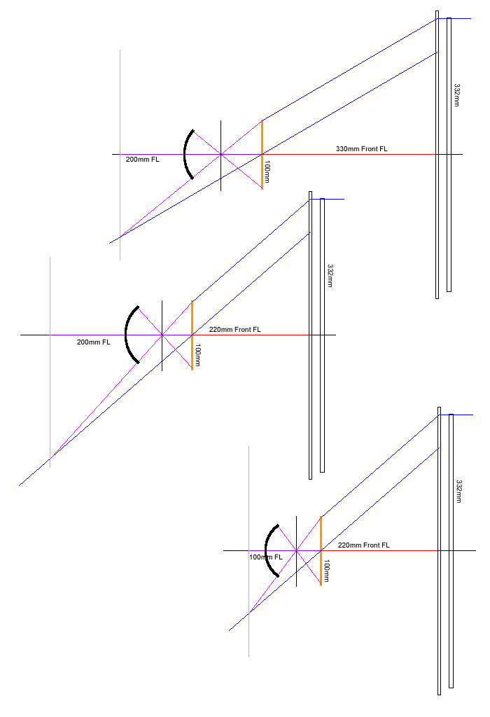

OK Guy,
If I'm getting this right, this means a shorter condenser fresnel FL will give you more usable light, and add to the benifit of a spherical reflector. Based on this, a shorter pre-condeser lens FL will also provide more usable light, at least up to a point.
See my images below for my reasoning.
Am I getting this right?
*edit for clarity
yes
Right. A shorter focal length pre-condensor lens can be placed closer to the lamp arc and still send all the captured light to the fresnels. By putting it closer to the lamp, it captures more of the lamp's light output. But if you get one with too short a focal length, then you will put it right up to the lamp's outer envelope and it still will converge the light into a cone too small to light the corners of the fresnel. Then you are SOL! :bawling:
Using a spherical reflector is independant of using a pre-condensor lens. It will increase the amount of light coming out the front of the lamp by reflecting the light coming out the back. If you do use both together, then the spherical reflector has to match the angular width of the light being captured by the pre-condensor lens. If it is too narrow then the image edges and corners will be much dimmer.

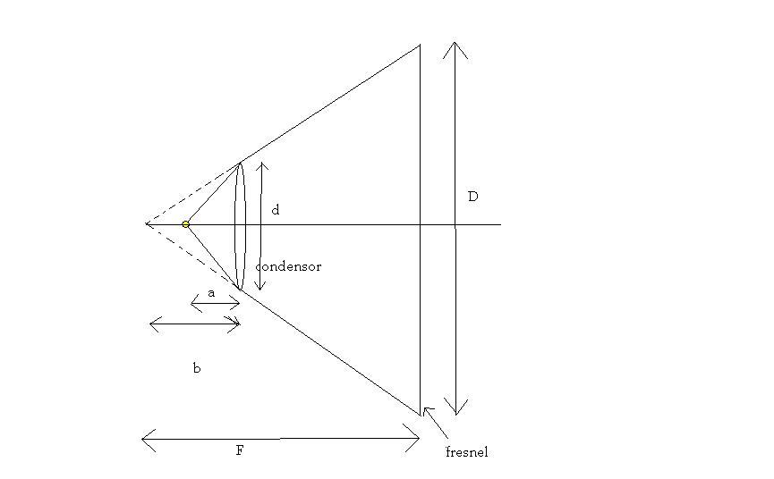

I came up with these equations for the different distances:
Fresnel focal length, F.
Fresnel and lcd size, D.
Condensor diameter, d.
Condensor focal length, f.
Distance between condensor and fresnel, x : D/F = d/b, x = F-b.
Distance from condensor to light arc, a: 1/a = 1/f + 1/b
Using my expected setup:
F= 210mm
D= 264mm
f=112 mm
d=76mm
I get b = 60.5mm, x = 149.5mm and a = 39.3mm.
Am I correct here?
How would I set up the corresponding equations for the projection lens?
looks right to me
