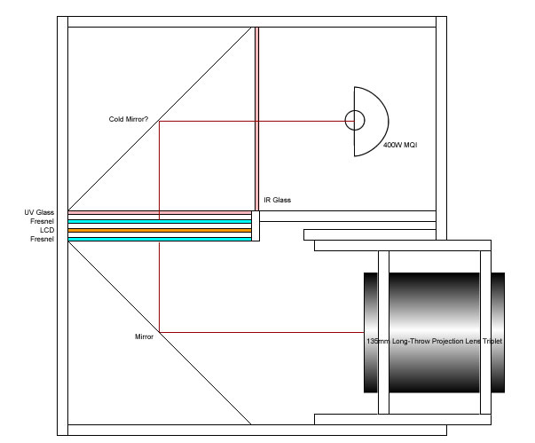

I think I’m going to use the 15.5x15.5 330mm rf fresnels and the 135mm Long-Throw Projection Lens Triplet from DIYProjectorCompany.
I’m pretty sure I’m going to go with the 400w MH MQI setup. I’m just not sure if I should go with DIYPC’s 4200k setup as I understand ~5100K is best.
Below you’ll see a sketch of the dual fold design I’m toying with now. When measuring focal length when folding light would you measure the distance represented by the red lines like I’m guessing?

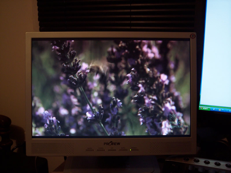

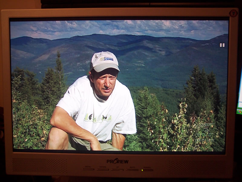

TaskMaster said:Do you see any lines in the picture like Ben_tech mentions in this thread ?
Nope I have no problems with my panel at all. No dead or stuck pixels or anything like Ben_tech describes. Other than the poor viewing angle and some minor backlight bleeding near the bottom of the display, I would say it is just as good as many much higher priced LCDs out there. IMHO, the LCD itself has very good colors and a good response time.
I should mention that the pics above are 720p content from my ATI HDTV Wonder card.
I find it unlikely that you're going to find a cold mirror anywhere near large enough to work, at a price anywhere near practicality.
I found some nice 6"-8" Rosco hot mirrors at B+H photo which I will probably be using, but those are gonna run me $60-$130. Large dichroics are REALLY expensive. Hot mirrors have an advantage that you can stick 'em right in the main beam near the bulb where it's still small.
Squalish said:I find it unlikely that you're going to find a cold mirror anywhere near large enough to work, at a price anywhere near practicality.
Unfortunately, you seem to be right. I have contacted several places, and the ones I have found are <6" & >80$, nowhere near practicality. I think I have found a supplier for 3mm 15.5x15.5" clear tempered glass with a 80% IR coating that the manufacturer thinks can handle a 96% UV coating on the back side (possible heat issue). I'm still waiting on a call back for verification and pricing from an engineer.
I also found some UV blocking fresnels but they are too expensive for my budget. From my research, acrylic fresnels should be inherently partially UV blocking anyway.
I think I may steer clear of a dual fold and go for a standup design with one front surface mirror. I’ve seen some nice fully adjustable designs like this, which have good keystone and focusing.

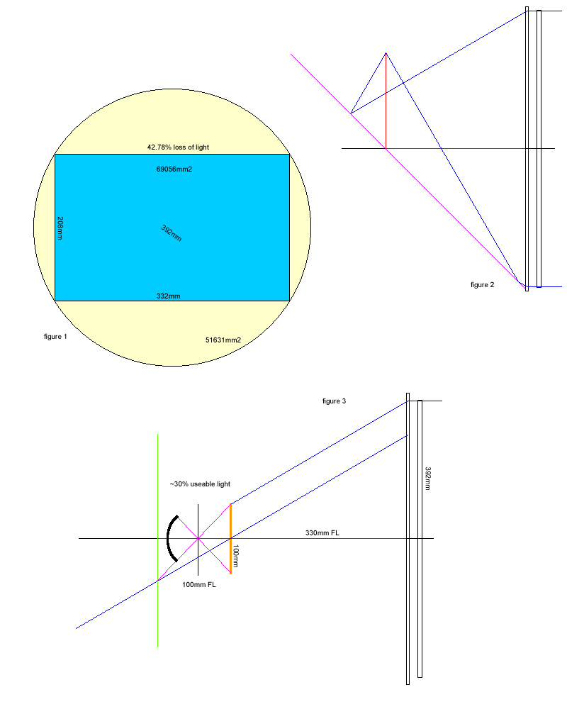

As for this drawing below...
Fig 1. I figure I'll be loosing 42.78% of the "good" light coming from the light engine. Are there any non-circular pre-condensers that would improve this?
Fig 2. My proof I can't fold the light before the LCD with this LCD without a much longer fresnel FL. I also belive the longer the frenel FL the less usable light is collected from your engine. Can anyone confirm this?
Fig 3. Pretty much the setup I'm looking into now. I just need to find a pre-condenser lens close to 100mm dia. and 100mm fl. This should give me ~30% good light from my engine. Maybe a 80mm with a <80mm fl would be better I'll have to draw that out....
30% - 43% (from fig 1) = 17.1% Damn these things are inefficient
Well back to the drawing board...

The ineffeciency of the system is real which is why we have to use a 15,000 - 20,000 lumen light. The LCD itself is rather ineffecient also.
Keep up the good work. I am planning on building a double parabolic reflector with the same aspect ratio as the LCD but this is going to be one of the hardest things to build on my projector.
I will be collimating the light and using only one fresnel but this of course requires the projector to be larger in size.
I think I am going to use this Proview LCD as I can't afford the 1980 x 1200 LCD controller combination that I had envisioned.

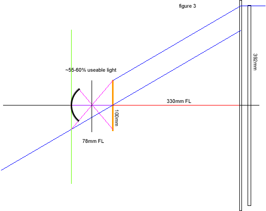

the AOI177 from AlignOptics looks very nice if my maths are correct.
100mm ASPH 77.8mm fl
I think I was a little too conservative on estimating the usable light from a 100mm 100mm fl lens would produce on my last drawing. Instead of ~30% I think it would be more like 47-52%. I think this 78mm fl would produce more like 55-60% perfectly usable light.
Remember this is with the perfect spherical reflector in place. I have yet to find these either
Anyone got a good source on these?
I also think this setup would still give plenty of room for cooling and may just allow for a small hot mirror to be placed before the condenser lens to help with IR. I'll draw up my ideas for the light box tonight.
