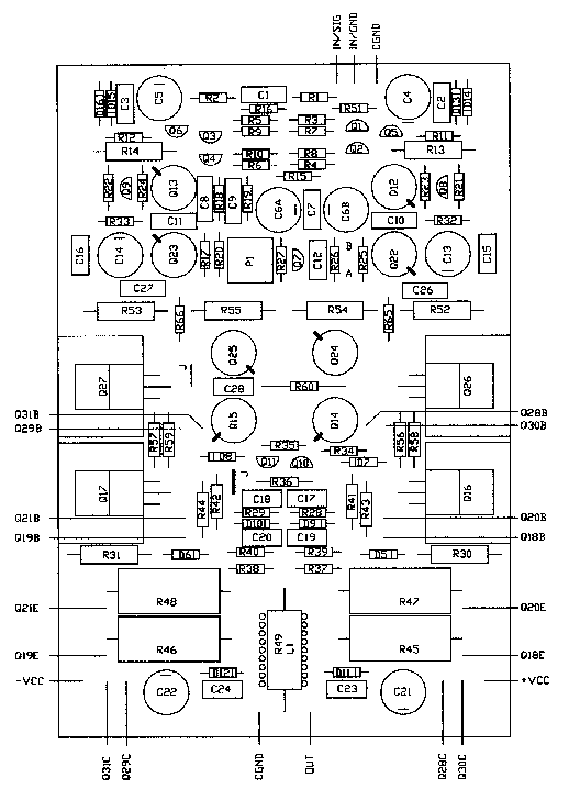

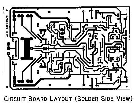

Here is the published board from Prof. Leach.
Measures approx. 6"x4". All components fit easily on one side and none of them is difficult to find.

The idea of many is to make it better.
I can easilly make original Leach boards, but i am most certainly not going to.
The pcb is the basis of an amplifier, and should be up to date.
Given the work and money involved a pcb with a professional layout and quality is the proper basis.
Leach did his layout for his students, and made it such that a pcb could be easilly made.
Maybe some may find building amplifiers in amateur diy quality sufficient, i believe most here try doing it better than the pro's.
I can do a better single sided layout of the Leach with a modern pcb designing program in 2 hours.
My pc can do it in Eagle, Ultiboard2001, Orcad, or a bunch of other programs( thank you, FTP's).
I'd alter the layout, certainly would not handwire the output devices, add some extra space for larger or additional components, change the TO3's for flatpacks, make the entire layout 1-dimensional, etc, etc , etc.
If others prefer such a layout too, and Jens likes to do us a favor, i gratefully ask Jens for 2 boards, and spend my diy time building the beasts.
Speaking only for myself, a layout like the original Leach is a waste of time. I invest a lot of effort, i want the best.

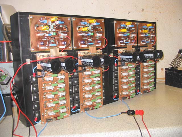

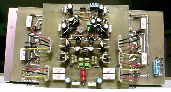

Hi Jens,
i think all will agree that your prototype board looks professional, the Leach board looks like it has been designed with rolls of tape.
I used to do that in the old days when i did not have the cash for a pc and design software.
The power stage board looks great, though i was hoping for a bit more space between output devices to place MT200 Sanken's or Toshiba's.
If a bigger number of diy members desire your layout and boards like the prototype, i go with the majority and use TO247's.
My preference would be a layout like your prototype, but with both stages on 1 board.
The dimensioning of the boards is to my liking, they are narrow enough to make great single-channel amplifiers, 19' types do not make nice monaural's.

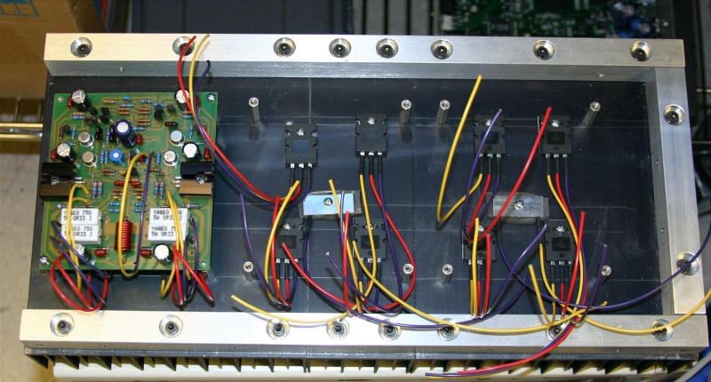

People seem to conclude that flat packs take a lot of heatsink space. I do not necessarily agree. One way that I find very compact is to have all the output devices in a single line on one edge of the board and place the board at 90 degrees from the heatsink using metal angles. This way you use only the minimal space on the heatsink. It does make the board slightly longer but it can be slimmer.
This is somewhat different of Jen's extended version... But you can stack many boards vertically or horizontally on the same heatsink.
Would it be possible for the Leach amp to be done that way?
Thanks,
Sébastien
One transistor is 20 mm wide... this results in a least 4 * 20 * 2 = 160 mm edge space + what is needed for drivers and emitter resistors... This does not leave any room for the MT-200 type transistor...
I guess it's one way of going, though I prefer to place the output transistors similar to my prototype design for better cooling (No L bracket)
I don't really care what format the boards are going to have...I'll get my heatsinks when the design is final.
What does everybody else like for layout?
\Jens
