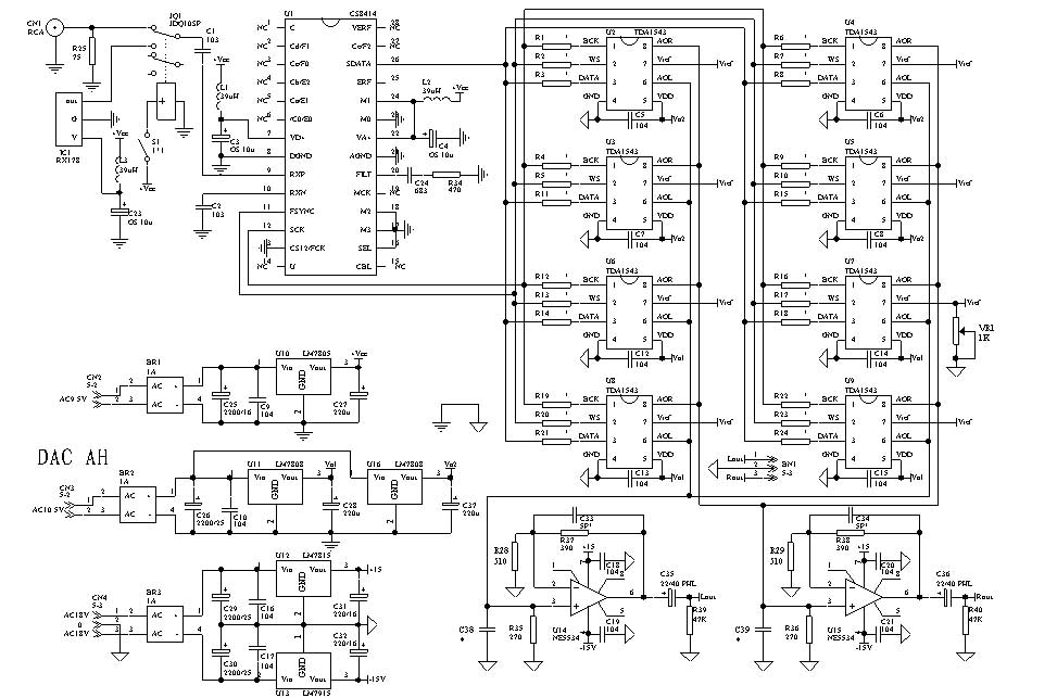

I pumbed into this DIY kit:
TDA1543 Non-oversampling DAC:
http://www.diyfidelity.com.au/product_info.php?cPath=0_35&products_id=41
The receiver chip used in this kit is a Crystal 8414 and the DAC chip is a Philips TDA1543 (8 connected in parallel).
1 x DAC PCB with digital and optical inputs
1 x 50W toroidal power transformer
ELNA For Audio capacitors
Burr Brown OPA602
It seems like a bargain and what is excellent about it is that all the components are allready soldered so I wouldn't have to worry about that. Tempting...
Could someone tell me more about that DAC design. I'm not interested in poor DAC since I allready have a CDP which I think is very goof.
Even good guesses are appreciated. 🙂

I've seen and read bout tDA1543 DACs but I would like to hear opinions about this particular design. Power supplies etc. If some guru would like to examine the DAC photos a little and give an opinion about it.
It all looks pretty standard. The input cannot offer true 75ohm termination which i've found to be important and the 8414 seems cap coupled to the spdif signal - no transformer or some kind of signal conditioning - IMO, no good.
Lots of individual resistors on the digital signal lines to the individual dacS - never seen this before but possibly a good idea. Ps seems bog standard which means inadequate. No idea how the opamp I/V works.

Thanks for answers.
I was thinking about the same issues. Power supply is a tricky thing to build without decent measuring equipment. Even the most simple circuit can work totally wrong even if everything seems to be ok.
And how about digital input. How difficult it is to add transformer or some kind of signal conditioning to it? I suppose not.
I suppose this DAC is not totally bad 😀 By making a few small mods it might even be very good. For example transformer could be replaced with batteries and an automatic charger?

The only part of the design which is not obvious from the pic is the I/V converter. My guess is on a textbook opamp circuit. What else can anyone possibly need to know? That the output elcos are Philips?

I built Doede's 1543 DAC using 8 parralleled 1543's. I also used the reclocker. The IV conversion is by resistor not Op-Amp...I had read where the 1543 does not do well with Op-Amp conversion.
The sub circuits (Reciever chip and reclocker) are powered by four separate Ni-cad packs of 4 cells each. The Dac chips are powered by a 12 volt lead acid battery, regulated down to 8 or nine volts.
When the unit is off, the batteries are charging and when the unit is on, I use the charging current to power a small fan to cool the DAC tower which gets real hot.
The whole project cost maybe $120. I think it sounds wonderful...better than my other DAC which as a kit was more than $1,000.
