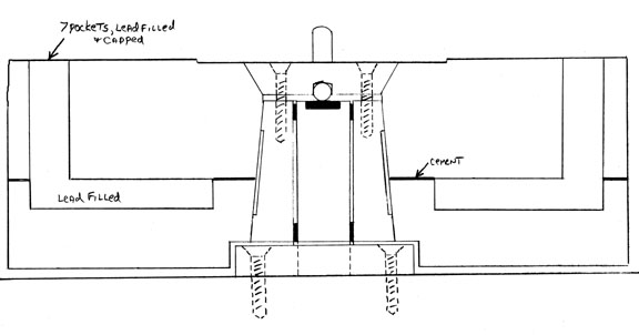

The base will be a 20" X 24" vibraplane. I may modify it to take up less space. I'll bolt down the components to it's top surface.
The bearing will be inverted. The center shaft will be 7/8 dia. Thomson Shaft, press fitted into a base flange 1/2" thick. Thomson Shaft is some sort of steel (sorry) case hardened .06 deep to Rc 60 and ground to an 8 finish. The shaft will be approx 3.5 inches long. It will have a piece of nylatron pressed into the top end to support the ball bearing (5/16 dia).
The bearing outer race: silicon bronze with 1.00 dia. bore. The O.D. is tapered 10 deg. approx. 2" dia. at top, 2.5" dia. at bottom. All but the top and bottom half inch or so on the O.D. is undercut. It will fit into a tapered bore in the 3.5 inch thick acrylic platter. In the bore of the outer bearing race will be two bearings, top and bottom, made of sintered bronze. Clearance will be .0003 to .0005 on diameter.
Above the shaft and bearing is a piece machined from silicon bronze that has the ball bearing pressed into the bottom. It is 1/2 " thick. The outer dia. is tapered 60 degrees, large end up, approx. 2" dia. at bottom. It has 3 countersunk holes that match 3 threaded 1/4-20 holes in the top of the outer race. It has a .281 dia. extending up for the record hole. It has a matchiing tapered bore in the top of the platter. So when the whole thing is assembled the pieces tighten into their respective tapered holes.
I think I'm going to drill a hole through the top "plug" for adding oil. I plan to just let the oil run out the bottom. I think if it is the right viscosity, it will run through very slowly, and will actually form a vacuum up above as it leaks out. That should slow it down. The oil fill hole will have a plug.

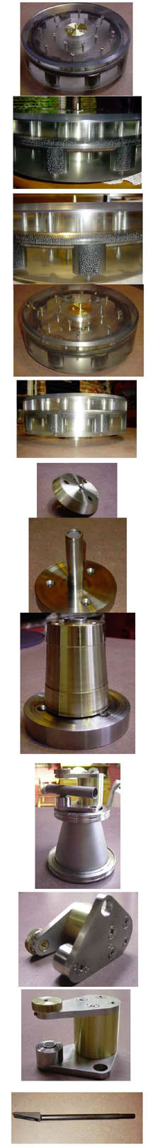

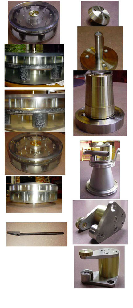

Finally, after many hours spent working through breaks at work, I have something to show. Some comments on the various components:
Platter: Two layers of acrylic...2" at bottom, then 1", then a piece of clear PVC (vinyl) on the top. The two pieces of acrylic have a circular, half round groove milled into the surfaces that join, to form a 20 mm dia. chamber that connects to the 8 bores. Lead shot is filled from the bottom. The top of the upper acrylic piece drops .06" going toward the center, and the PVC is restrained down to it. Right now the only thing holding the PVC down is the upper spindle piece that contains the thrust bearing. I have to add bolts. Weight= 26 lbs. I posted a the original bearing/platter sketch in another thread- I should re-post it here.
Shroder clone: Drilling the magnet was not a problem- I used a .025" Carbide end mill, then counterbored with a 1/16 end mill to provide space for the knot. The holes in the armwand tube were not centered good enough, so I have to do that over- the magnets won't stay parallel. I used .025" dia. Kevlar thread, but it seems too stiff- I'm going to try heavy nylon thread.
That interesting piece holding up the Shroder is a hollow stainless reduction fitting from an exhaust system- just the right height. I will probably fill it with lead shot and modify the top.
Armwand: Two woods used- the outer piece is African Blackwood with a 3/8 dia. hole through it. A 3/8 dowel of Black Palm is inserted (press fitted) into it, and the BP has two tiny grooves running down the side for wires. It was soaked in Teak oil for 3 weeks. Right now it will make an effective lenth of 12", but I think I want to cut down the length to 9-10", and also reduce the diameter and remove the sides on the headshell to allow a cart to be mounted at an offset angle.
Still to be made are the clamp and tonearm lift, and a means of adjusting VTA.
Enjoy!

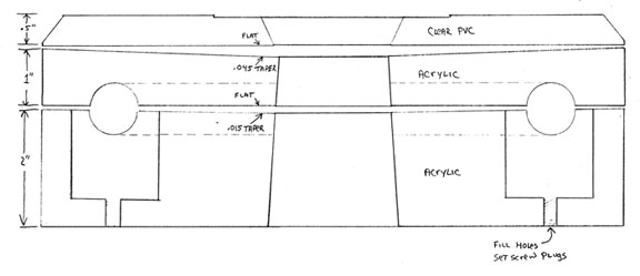

Final design
This is how the platter ended up, not showing the bearing or bolts.
The middle piece is bolted to the bottom piece, and for the time being, the top piece is only being restrained down in the center. I'm going to have to bolt that piece down as well.
You can see that the resulting slope of the top of the platter is .060".

Hmm, how do I explain this? Many times I don't really know why I do things the way I do, just go by gut feeling. I felt that forcing the two pieces together to close the gap would make them more solid as a whole, and fewer bolts would be needed. The same reason applies to the top surface, but another reason applies there. Since the top piece is clear PVC, I couldn't take a cut on the top or bottom surface of it and then polish it for clarity. PVC is pretty soft, and just doesn't polish very well.
Hope that 'splains it for you.
Colby

Hi
The tapper is a good ideer, this is selfaligned. but it is very important that these angles are "dead on".
But I see a problem in aligning the ball to the center of the bearing when you using 3 bolts hold it. I would prefere to have a 45drg. hole a the top of the shaft, which can be done on a lathe. and place the ball in this hole. On the topplate i would glue a piece of carbid, f.ex. a insert from a insertcutter.
Its very important to have centret the ball, if not the platte will tend to "wobble".
Claus
Thanks, Claus
The angles (I'm assuming you are talking about the outer diameter of the bearing) are in fact, dead on. The lathe set-up was the same when I cut the bearing O.D. as when I cut the platter I.D., and the acrylic pieces were bolted together then.
The thrust bearing design is flawed somewhat, because when I tighten one of the 3 screws, it moves the ball off center. I have to rely on the top surface running true, and checking it with a dial indicator. I may have to dowel pin these together to make sure that everything stays concentric.
