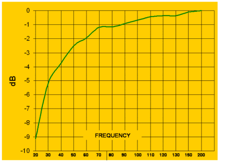

Bass Shy
We all know that the cute little Sonic Impact is bass shy.
Measurements show that it is. Have a look at this graph.
Level was 2V P-P for this measurement, but seemed the same for all levels.
This chart is not yet on my site. You saw it here first!
Aloha
MM
Aloha
MM
Re: Bass Shy
MM,
This is about what I hear. My speakers only go to about 38 Hz before they roll off steeply. The SI is rolling off way before they do.
But you mentioned that this is not level dependent. Is it loading dependent? Do the 4 ohm and 8 ohm curves overlay?
My speakers are 15 ohm, I wonder if the power transfer is better into higher impedances. The zobel on the output may be adjustable to compensate a little.
It is surprising that the lowend roll off is not power related. Guess it shows that the inductors are not saturating.
George

Re: Re: Bass Shy
Well, George,
to be honest I did not run the curves at a broad range of powers, just typical musical levels. Those tiny little inductors are certainly suspect (maybe for ringing too). But my guess is that the input may be to blame.
I'll check again at maximum output and under 16 & 4 ohm loads.
Thanks for the suggestion.
FWIW, I find it surprising that you are able to use the SI with 15 ohm speakers. It just doesn't put out enough power at that impedance. Your drivers must be very efficient.
Aloha
MM

Re: Re: Re: Bass Shy
If the problem is in the input it is not easily fixable. That will also explain if not level or load dependent.
Also, the speakers are 100 dB efficient, so the 3 1/2 watts or so from the SI is more than enough. Even a 45 tube amp at about 1 watt is loud enough, just too soft and colored.
George

My guess on the bass-shyness of the Sonic Impact is the small chip caps used to block DC. I suspect replacing them with a larger value capacitor would probably fix this issue. I haven't been able to determine the value of the chip on-board, though. I don't have a capacitence meter, and there's no visible markings on the chip.
Bypassable
I use a transformer coupled preamp, can I bypass these caps?
George
