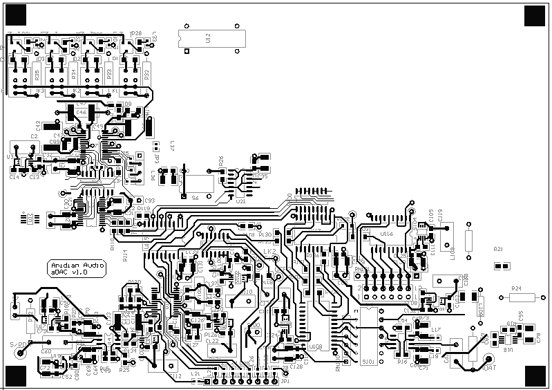

As certain people are aware, I've been working on a DAC for some time. I've come to a crossroads, as I've found a way to (somewhat) reasonably have some boards manufactured. To do this economically, I'd have to modularize the design a bit. The question is, is it worth it? Would anyone be interested in the boards?
Some details:
192kHz upsampling via AD1896
192kHz DAC, AD1853
TI DIR1703 FIFO reciever IC
AD8561 or LT1016 input comparator
Analog attenuation via relays and fixed resistors (optional)
Regulators onboard for each IC
Very generous allowances for bypassing
No routing through groundplane
This board is very SMT-intensive; it had to be for best quality. The boards would be professionally manufactured 2-layer throughhole plated with SMOBC soldermask.
I will be publishing I/V outlines, but not having boards manufactured.
I'm thinking $30 for the boards, less if I end up with some definites by the time I place an order. Anyone interested?
You can find some schematics on my site:
http://www.anidian.com/audio/construct/adac_1.shtml
I am afraid these are a bit out of date, because it was getting to be a bear to keep the site up to date and finish the board at the same time. A boardshot from last week is below; the actual DAC/ASRC block is on the left with the S/PDIF reciever below. The "public consumption" design will be simplified, as I expect few will require 6 channels or an ADAT reciever. 😉
If there is enough interest to order boards, I'll make the design a bit modular so it can accomadate 2-6 channels, or alternatively paralleled DACs. After all, I want multichannel even if no one else does. ^_^
Simplified boards will probably be 5"x5", with DAC module cutoffs that are considerably smaller.

Well, the new board isn't routed 100%, but it is pretty close. I did some things to make it more flexible, like support for
  • axial (standard) or radial (MK132) resistors in the IREF control
  • single, one-at-a-time, or R2R attenuator (32 steps)
  • full or half size master clock
  • enough room to mount discrete master clock or small OXCO
  • add-on DAC boards
  • alternative inputs
The add-on DACs will be cutoff boards consisting of AD1896, AD1853, and the relays only. These boards can be used to increase the number of channels or improve the S/N ratio. There are clock outputs for 2 additional DAC boards. Three could probably be done by doubling up one of the 74HC04 outputs.
I'll be posting the updated schematics to my site monday or tuesday. Now is the time if anyone has input on the design. 😉

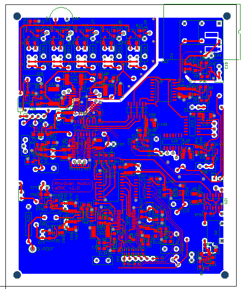

Here is a shot of the ground plane. Please ignore the trace cutting across the DAC...this will probably end up being the only jumper on the board, so it won't interrupt the groundplane.
I've added some guard traces on the topside around analog sections or where the inharmonic clock is routed.
It is hard to tell exactly without schematics, but here is a try from me. Please excuse me if these issues have already been adressed:
1. Is there an ADAT input still?
2. I am very pleased that you have added support for various types of IREF resistors and that the SRC's have been moved to the DAC daughter boards.
3. This may be sacrilege since I know how much emphasis you place on decoupling, but is there room for the following decoupling scenario http://www.diyaudio.com/forums/showthread.php?threadid=4562&pagenumber=4
(see diagram) ref our participation in that thread?
4. I cannot see which regulators are used. Please advice.
Nice work!
Petter
Thanks for the compliments and the feedback Petter...I know this won't address all your questions but I am working on it. 😉 Okay, here is a boardshot in PDF format that is actually readable.
http://www.anidian.com/audio/pdf/boardshot.pdf
U7 (top SSOP) AD1853
U2 (mid SSOP) AD1896
U106 (bot SSOP) DIR1701 (or DIR1703)
The unidentifiable chip to the left of the reciever is an AD8561 (or LT1016) comparator. The network in the bottom right is the high-frequency (28MHz+) clock for AD1896. The network in the upper right is the divider and buffer network that generates MCK (24.576MHz), BCK, and LRCK.
Regulators are LT1762 (positive, <20uV noise) and LT1964 (negative, <30uV noise).
The ADAT reciever has disappeared, but will be back on its own board module. The reason for this was mainly cost (trying to maximize panel usage) and also flexibility. I wasn't sure many people would want the ADAT as designed...after all, the electrical interface wouldn't be compatible with off-the-shelf equipment. I may cook up two photo-etchable versions of the ADAT board...one for people like me, and one for "standard" usage.
Due to various considerations, I haven't duplicated ftorres' excellant bypassing work, but I have taken it into account as much as possible. Most of the bypassing is an 0805 right on the supply pad (intended to be 3.3uF stacked on 100nF) followed immediatly by 1210 (up to 22uF ceramic or tantalum) and a 100mil radial suitable for 220uF Panasonic FC or a more exotic cap. Regulators generally have 0805 pad at output and input and room for 680-1000uF FC at input, and are decoupled from the supply line by an inductor. Separate supply lines are run for analog and digital.
I've also updated all the schematic documents so you can get a pretty good idea of what the final design will be like. Check those out here:
I have added ADM707 to the board, per AD datasheet and with manual reset (except with 4k7 series resistor on the reset line so that uP can control it). The board should be ready to run with or without external reset/controls.
This wraps up the board routing. I'll be doing some QA and hopefully send the design out to be fabbed in the next week or so. I'm still open to any suggestions or requests.
