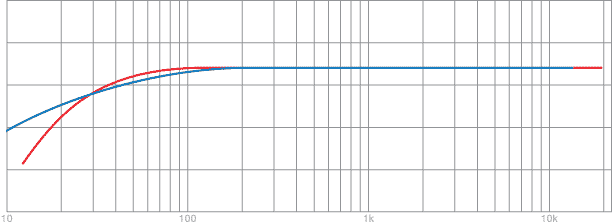

frugal-phile™
Joined 2001
not a perfect illustration, but blue is lower Q... ultimately thet should have the same roll-off
dave

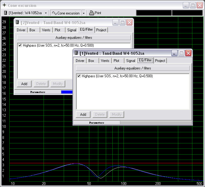

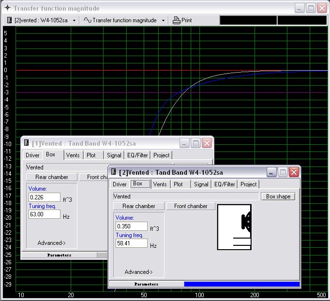

Thanks for all the help! I was able to model a .5 Q filter, and I was a bit taken aback at first! The rolloff does start quite a bit sooner, so much so that my 65hz f3 turned into a 100+ hz f3!
So I played around a bit, and eventually wound up lowering the HPF to 50hz. I also tried modeling a larger box with a more traditional alignment to see it I could get more bass response, with surprising results...
The 100hz bump that the smaller SBB4 alignment has naturally combines nicely with the low-Q filter to make what looks like a higher-Q-filter rolloff. The larger alignment has a hair more extension in the very low end, but rolls off so early that the trade-off in midbass isn't worth it, IMO.
Here's the excursion plots at 10 watts for both boxes (QB4 is blue, SBB4 is gray):
