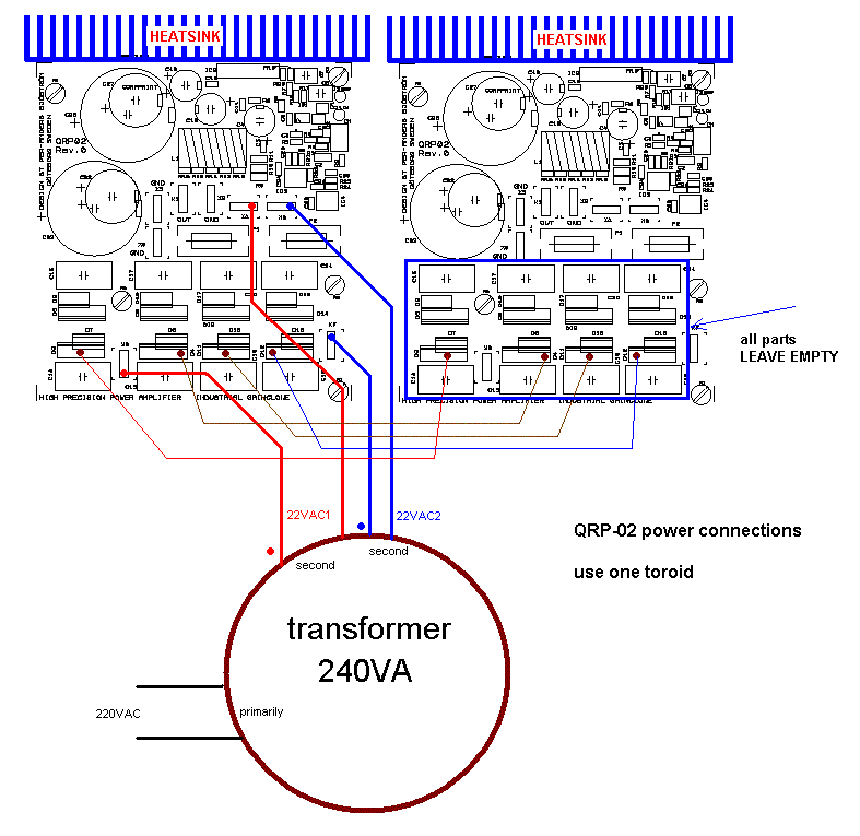

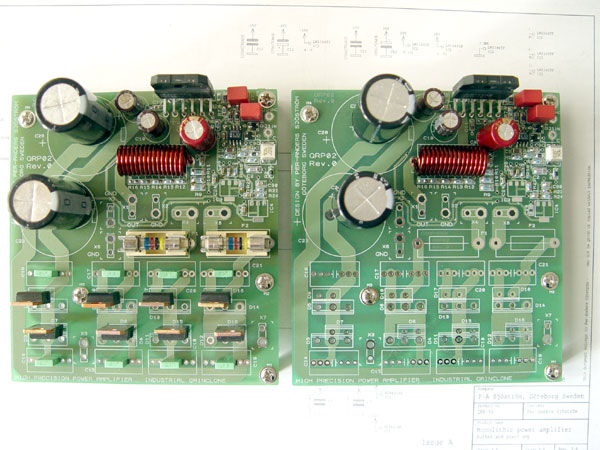

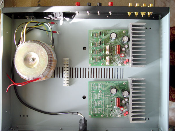

What I made is an integrated amp.I use one 240VA 2 X 22VAC toriod, for power supply.
the attached drawing show the psu connections.

I wish you good luck with the grounding becasue the pcb is made for one transformer per pcb. If you succeed to make a silent and humfree amp you have succeeded.
peranders said:I wish you good luck with the grounding becasue the pcb is made for one transformer per pcb. If you succeed to make a silent and humfree amp you have succeeded.
Just like designing an amplifier, grounding is also an art form.
Some people fight with it forever, some get it with minimal fuss.
The thing was that I designed this board for one transformer each just because of the grounding problems people have with other designs.
If you only connect one transformer per pcb you will get a hum/thump/click free amp! 🙂 The grounding is ready and you don't have to think about this.

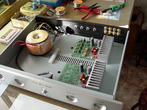

My gainclone was already playing music for some time. NO click/ thump during power on/off and specially no hum. 🙂
During testing of the first pcb, the voltage at the speaker output, it reads 36V. But after replacing the LM3886, the voltage becomes 0V, I mean 0mV.
As of now, I am using a 22k volume as a passive pre-amp between the cd player and amplifier. The sound is very natural and relaxing. I can listen to it continously the whole day.

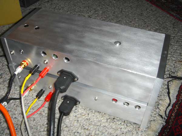

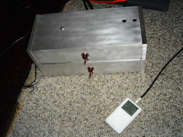

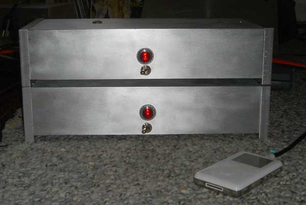

Here's mine.
I just finished them. The chassis is made of an aluminum square beam (hollow in the middle) 1/4in thickness. The sides are 1/2in thick. I cut the squares 12 3/4in wide, and cut the bottom out to install the components.
My transformers are hand wound (by me!) and they provide 2 secondaries of 25.75vac and a 6v for a diode and led. I installed the red leds in an antique light housing.
All power wires are solid copper, signal wires are cat6.
