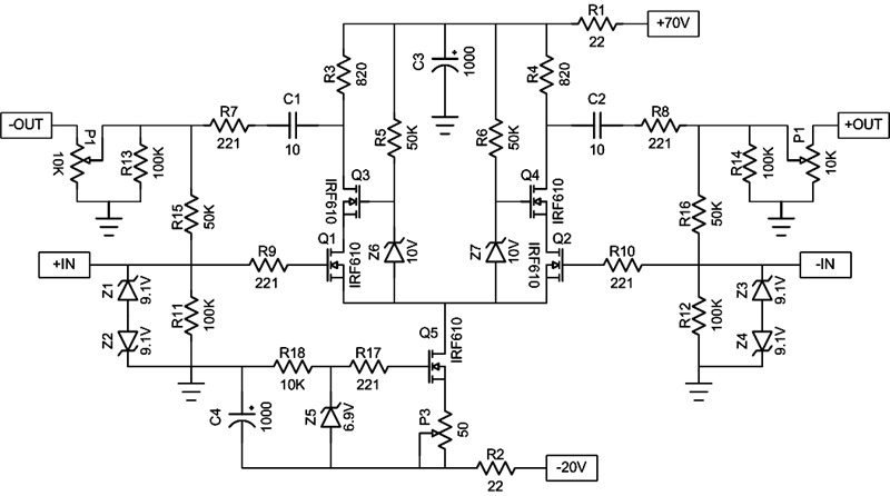

For those interested, I have attached the schematic below. The only difference between what I indicate there and what I did in reality is that I substituted precision voltage references for the zener diodes in the CCS and cascodes.

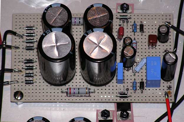

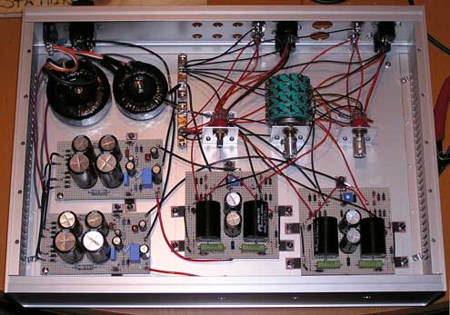

Two transformers were the minimum requirement in order to supply the +70/-20 volts rails. I split the powersupply to dual mono after the transformers but before the rectifier bridges to minimize as much as possible the crosstalk without incurring too much expense. In the end I would not have had enough room in the chassis for the extra transformers required by true dual mono, so it was a good decision. I also provided separate star grounds to each channel, which are connected to chassis/AC ground via CL60 thermistors.
Closer view of one channels PS board, which includes dual rectifier bridges using 1N4004 diodes, a CRC filter, and regulation before passing power out to the amplifier boards.

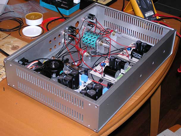

The result: with no input signal, the volume control set to maximum, the preamp connected to an amp with 35dB gain that is then connected to 89dB speakers, and your ears right next to the speaker, you can just hear a bit of white noise. I'm very pleased with the result.

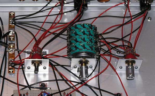

The other complication I threw in was that I wanted to be able to switch between single-ened and balanced input and outputs just by turning knobs on the front panel, i.e. doesn't require insertion of jumpers into XLR connectors to enable single-ended operation. Thus the extra birdsnest if wiring between input selector switch (left) the balanced series attenuator (center) and the output selector (right). I think that decision will come back to bite me, but so far it works quite well.

How do you define the gain in the circuit when you don´t use resistors in the sources?

metalman,
I have a question regarding the current in the CCS zener,
with -20 volts minus 6.8 = 13.2 volts for the R18 = 10 K
that is 13.2/10000 = 1.32 mA I think a better value would be
around 5 to 10 mA to get better stability... so I suggest 2.6 K
plus putting a 20 mF across this zener would provide lesser
background noise.
Otherwise its perfect! very nice job. 🙂

Nope, the left one is an input select switch, the middle is a stepped attenuator for volume control on the output, and the right one is the output select switch.Originally posted by relder

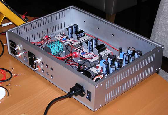

The case is from Lansing Enclosures. Great quality and I was impressed with their service. For people like me who literally build this on their kitchen table (condo living = no workshop) it is a great option. I will be using them again.Originally posted by ble0t

The gain is 13dB, defined by the X-feedback resistors R15 and R16 on my schematic. The source resistors were omitted to maximize the effect of the supersymmetry, a suggestion Nelson posted in another thread.Originally posted by kimchips

That is not actually a Zener in my circuit but an LM329 precision voltage reference, and according to its data sheet it should be in its optimal operating range at ~1.5mA. I tossed back and forth on whether to use a zener with something similar to your suggestions, versus the LM329, and in the end I tossed a coin. I suspect I will find myself trying some alternate arrangements over the next few months to see what differences the various approaches create.Originally posted by Alain Dupont

Hi Terry!
Really nice work.
But acording to my book, you need some inputresistors at say 10K in order to get X. The feedback needs this input resistance in order to dampen the input signal and thus make the X efficient.
And what a nice job you have done on the XGC.
Really nice work.
DOH!!!... again,
Sheesh, that's twice in a fairly short period that I've pooched a posted schematic. That's what I get for rushing a drawing in order to get some posting done.
Better put a leash on my enthusiasm, and add a review step to my circuit drawing!🙄

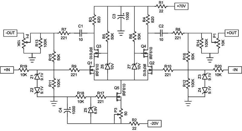

Henrik's observation is absolutely correct, and I do indeed have 10k resistors at the inputs in my functioning circuit. I'll correct this and post a correction shortly. Thanks Henrik, both for the correction and the inspiration.😉
I'm just working on getting my extension rods and knobs installed. This project is starting to look like a real preamp!

OK, thanks to Henrik's keen eye catching a discrepancy in the earlier schematic, here is the correct schematic.
To those who Nelson has referred here who are interested in using this circuit as a single-ended to balanced converter, please note that you will need to connect the -In terminal to ground for it to act optimally as a converter. Also note that the 10K potentiometer at the outputs is meant as a volume control. Without attenutation, this circuit has 13dB of gain.
One last point overall is that P3 can be adjusted to set the bias current. I optimized this circuit to run best with ~32 volt drop across the 820ohm resistors R3 & R4, which should be 5W rated.
Cheers, Terry.
