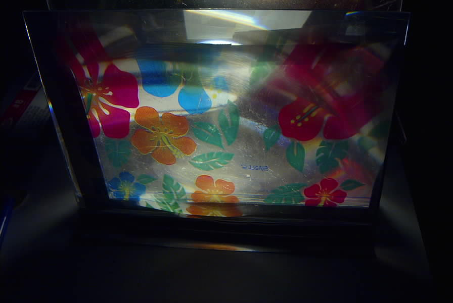

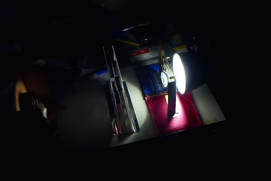

I will be posting some test bench pics
First up,
Full bench,
That is not the Icecap Ballast and HQI bulb, by the way, I hope I can get some of the same results with it. I was just getting my reflector and condensor distances straightened out first. Got some good results with just a 75 watt incandescant desklamp.
First up,
Full bench,
Nothing was staked down or precisely placed. I just eye-balled it all in line and made small adjustments until I got tis image on the wall. The paper has light blue graph lines in it. I figure this is pretty good detail for a 75W house bulb and eye-balled centerline! The detail is actually a little finer and I can even see some of the wrinkles in the testscreen. I'm not a very good photographer, and I don't have a tripod so I am moving a little. (tried holding my breath a-la Splinter Cell; worked a little bit)

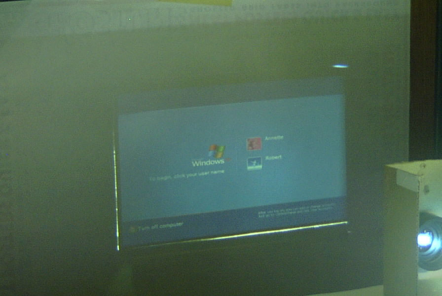

I was bound and determined to get this thing working tonight to meet my superbowl deadline and I found the problem. I first lightly filed the FFC from the button panel to the mian controller board. Then I noticed there were 14 pins on the connecter on the button panel. There are only 13 pins on the cable. You have to make sure you have the cable going into the right set of pins.if you have the wrong one open the entire LCD will not operate.
I was certain the controller board was zonked. ACE suggested that I check the cables again. I had already took my meter to them and I was getting values on both ends of the cable so I ruled it out.
Ace suggested that I check at the back of the connecters instead. I kept getting problems at those end leads. So I lightly filed the cable. Nothing... then I counted the leads and that's when I noticed that there was one more lead on the connecter than the cable. So I tried it on one side, nothing.. tried it on the otherside and, Vóila! A working LCD!
Lost a few hours but I still can make it! 😎
Steamer
( colors are washed out because of the extra light fro the light engine that has not been corraled)

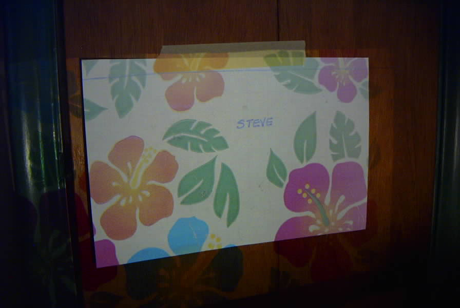

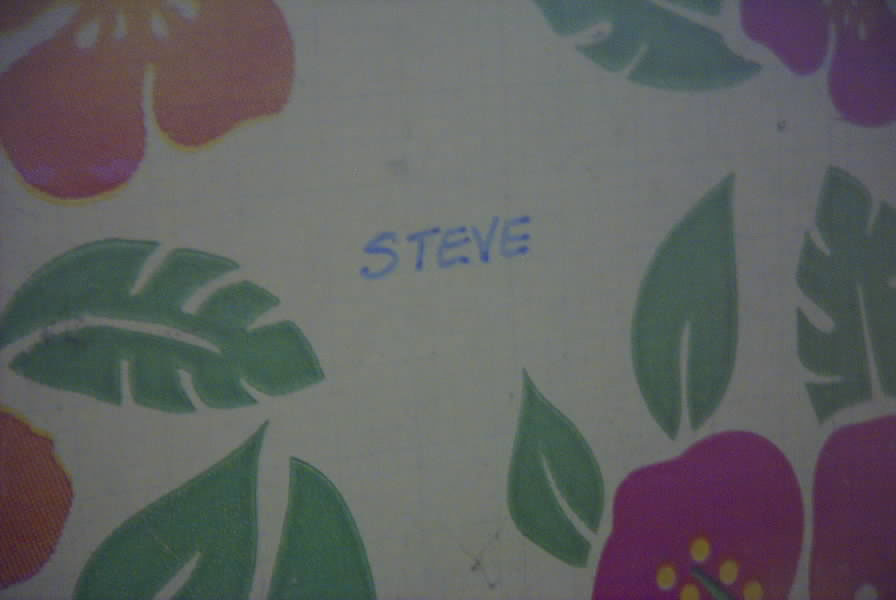

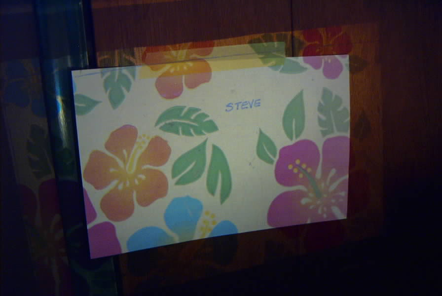

So how is the picture ?
Is it worth the build?
I wan't to make a Lilliput also, but want to make sure the Res is there before I spend the dough.
;P
;P
The picture from these lilliputs are awesome. Have a look in ACE's thread
