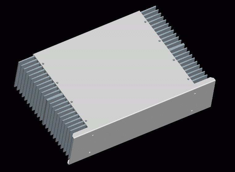

haha,yes ,Americian call stainless steel as SS,we call it SUS304,
2mm thickness,so hard!sand mask finished..
I am Poor ,but I work in a facty producing oven,so I have chance
to own this material...
I want to Build JLH MOS version amp,prepare this shell for it...
sorry for my poor english!

DarkHorse: How is ss as a heatsink? Aluminium is supposed to be quite good because it spreads the heat out well.

hi Bikeman:
sure,the heatsink isn't ss material..it is made of aluminium .
about 1Kg each,4 PCS total,each transistor own one..I think it is enough to spreads the heat when the machine runing..
wish good!
