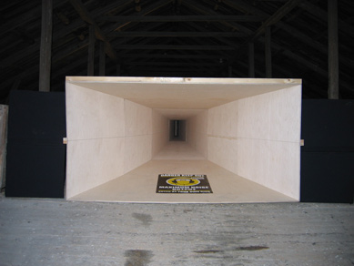

Hi!
I just finished my brand new 8,8 meter long large format basshorn. Not quite done with the bracing and finish yet, but I had to do some listening tests with a crew from Norwegian national TV. And of course take some pictures🙂
The 6090 Monster has almost flat frequency response from 18 to 100 Hz and has a low frequency limit of 9,7 Hz.
The transients were really impressive.
We played a recording of an earthquake and this is the first time I have heard the last ten seconds of that track even though I have subs with a 20 Hz limit in my living room.
I'm wondering if this is the worlds largest single 15" straight basshorn?
It is buildt in ten pieces, so it is kind of mobile😉
Best regards
Rune Skramstad

Wow, impressive. I want one of those 😀 Pitty my room would be about 3.5m long and wide. Plus I dont have the money or skills for that. But I would love some low thunderous bass😀
Rune,
Must say that's mighty impressive. Useful too...if you have a chicken farm and want to speed up the de-feathering process. No need for hot water.
How's the other one coming along?
It is stereo isn't it? 😉

Hi!
Here are some more info:
Efficiency is 105 dB @ 1m with one watt of power in the bandwidth from 18-150 Hz.
I have'nt got a chicken farm, but one of my friends have 8000 chickens, so it is a possibility that we can try out Cal Weldons proposal😉
The other one is coming as soon as I have enough space, maybe during summer.
I would rather want a car for the horn than the horn for my current car. It did not fit into a 64 cubicmeter truck, so I hope you have a large car Mr Joules🙂
The horn is designed for the PHL Audio 6090, but since it is built in pieces it would be possible to change the start of the throat. Then you have a lot of choices, maybe a quadruple PHL Audio 7090 or 6174s from McCauley.
The whole purpose with the horn as it stands right now is to see how detailed and loud a single 15" driver can be if proper loaded.

can you publish some technical design info on the horn?
throat area, mouth area, Fc (cutoff frequency), M (exponential or hyperbolic), flare rate, etc.

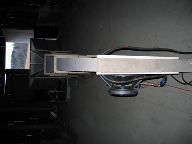

Hi!
Some more technical info:
Inner throat area 0,025 square m (not so strange as you might think since the driver is sideloaded), inner mouth area 2,88 square m (without basswings), -3dB point @ 16 Hz (without basswings), the horn is a combination of conical and exponential segments since the intention with it is good sound quality at low frequencies. I do not think a hyperbolic design would sound as nice as the current horn, but it certainly would have been louder.
I would be pleased if someone could tell me more about the Ascendant Audio Avalanche 18" driver (a link or S & T parameters). Maybe a quadruple throat with those will do the trix🙂
If I'm gonna use it or not? The answer is of course a big YES.
I have even invited some friends to dinner with me in the horn. Muzak will of course be pipe organ music and earthquakes.
The event will take place during this weekend, and I think milkshake would be a proper fluid for the happening.
Anyone got an idea for food?
Fullrange idea:
I have been thinking of making the 6090 Monster a triaxial design with an Altec Lansing 417-8H loading a 2 meter horn with an 299-8AT loaded Altec Lansing MR2542 inside. It seems like this could be a nice 40*20 fullrange speaker.
What do you think about that idea?
Someone got any proposal for other good 12" midrange drivers than the 417-8H?

I'm always serious of course, both about building another one and that I need more space before I do so🙂
Thanks for the food proposal.
A ten inch would do, but the Selenium driver looked kind of weak compared to the Altec Lansing 12" driver. It also seemed like the frequency response was built as a mountain with the top around 800 Hz which is not good considering crossover with the 299 driver. But thank you for the tip.
Wow, the Avalanche 18" seems like a great bassdriver.
I agree with you that it is not a good driver for traditional horn loading. But it is an excellent choice for basshorns containing non traditional horn loading. It would not work properly loaded on to the 6090 Monster because the throat is designed for a lower x-max driver, but the first 4 meters of the horn could be changed with a proper throat for the Avalanche.
This kind of drivers which we may can call a crossover between car woofers and PA woofers performs much better at low frequencies than traditional car woofers or PA woofers. They have tremendous force and speed in the lowest octaves.
I have tested out similar types of woofers but the Avalanche have better specs, so I certainly want to check out Ascendant audio.
