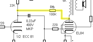

audiousername said:feedback from the plate to grid
Isn't it plate-to-plate?
dave
Yeah, but the driver's plate is connected to the output valve's grid....
I probably should have still said plate-to-plate though.
Jason
Jason
audiousername said:Yeah, but the driver's plate is connected to the output valve's grid....
You've got me confused.... that is independent of the feedback...
From Alex's RH84.
dave

Dave,
In AC terms, the plate of the driver valve is basically the same point as the grid of the output valve since they are coupled with a capacitor (which is an effective short to AC), and a gridstopper (which is a small resistance against the effectively infinite grid input resistance).
That was what I was thinking, but it was actually sloppy terminology on my part.
It is more correct to say plate to plate.
Jason
Jason
audiousername said:In AC terms, the plate of the driver valve is basically the same point as the grid of the output valve since they are coupled with a capacitor (which is an effective short to AC), and a gridstopper (which is a small resistance against the effectively infinite grid input resistance).
Thanx... i get that...
dave
PLATE TO PLATE!

Always nice to argue about terminology!
I'd submit that "plate to grid" is more appropriate. Let's do a reductio ad absurdem: remove the driver tube. Is the feedback still effective? Yes. Has the gain of the output stage risen to its open-loop value? No.

SY said:I'd submit that "plate to grid" is more appropriate. Let's do a reductio ad absurdem: remove the driver tube. Is the feedback still effective? Yes. Has the gain of the output stage risen to its open-loop value? No.
I hadn't thought of that before. It makes sense.
"Plate-to-grid" is more appropriate after all 😀
Muddy Waters
I'd call it local feedback. The feedback is applied from anode (plate) to grid of each output valve (toob). The fact that it was more convenient (and more stable) to make the grid connection before the coupling capacitor is neither here nor there.
EC, you miss the point. If one calls it "local feedback," then it's nothing novel and not worthy of discussion.
