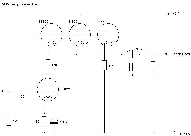

SRPP headphoneamp with E88CC
Hi guys!
what do you think about this design?
i only approximated the values so i will need some input from you..
it's intended to drive 32 ohm cans..
I've made one of those before settling on other tubes 🙂
Lose the 4k7 to ground, up the B+ to 250V and add one more capacitor across the output caps, a 0.1 to 0.47uF poly.
If you get distortion at too low levels, add 68R in series with the phones.
Then yer shmokin' 😀
thanks for your replies guys!
..SRPP...well maybe i should call the circuit SEPP instead?
-> fscarpa58
do you really 100uf at the output is sufficient, i'd rather raise the value to 680uF than lower it to 100uF, as far as i recall the higher capacitance the lower will the -3dB point be..?!
(though not extremely low..)
->geek
and what is your opinion about the sound of circuits like this? could i get away with a total of only three triodes?
->Sch3mat1c
well... my thought was to do something different from the usual cathodefollower.. 😎
-is it realistic to think that the output would swing about 1,5-2V p-p?
-my intention is to try this kind of topology and, of course, later on cannabilise
it for parts (like most of my projects..) if this project doesn't perform well enough.. *lol*

You could if you have sensitive enough headphones. Build the circuit on a breadboard and give it a try. Is the sound to your liking? Is the volume enough? If yes, you have a winner 😉
If the sound isn't OK, try different tubes (Paralleled 6N1P are pretty good too 😉 ). If the sound is OK, but not the volume, use more tubes.
Neither.
BTW, the top triodes aren't biased properly either, PSRR is virtually nonexistant too.
May I suggest a SRPP stage followed by a WCF a la John Broskie's Aikido circuit?
With a decent PS and a volume control on the input it could double as a superb little preamp as well.
It would do nicely with all the gain AND drive for any headphone, even the lowest input impedance and silliest interconnect capacitance could be driven from that, hands down.
Cheers, 😉

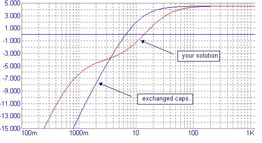

hi
do you really 100uf at the output is sufficient, i'd rather raise the value to 680uF than ...
The question is different. It is the 100u cap at the catode that
in isufficient. It is mandatory to rise its value. My solution is
at no cost and, yes, 100u at the output are sufficient but you
may increase this value as you feel. But, again, a value of
100u at the output and 1000u as bypass is also better.
So, the important thing is to rise the bypass cap.
Sure, but do not forget the bypass cap. If it is not enough large
at low freq. there will be a feedback with lower gain.
In fact, look at the following pic.
