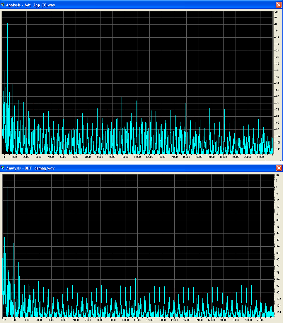

John Swenson used a spectrum analyser to determine the measurable difference before and after degaussing. His test was on Beam Deflection Tubes so we probably can't extrapolate it to "normal" or other tubes. But I found it an interesting experiment nevertheless.
http://db.audioasylum.com/cgi/m.mpl?forum=tubediy&n=57559&highlight=demagnetization&r=&session=

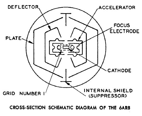

The 6AR8 is most certainly not the 'average' valve....
Have a look at the cross section diagram attached (From the GEC Datasheet)
It looks like the measurement is the spectrum resulting from a ~500Hz input (the 0dB reference). So it seems that it resulted in increased second and third harmonic, while decreasing higher orders and noise.
That's what I said...too...

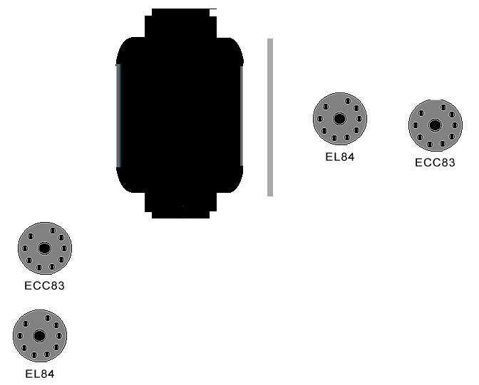

Attached is a image of a modefied Tanberg circuit,
there is a shield between the mainsT, and right 84/83.
Under the moding prosses, i forgot to attach the shield,
resulting in that the right 84 did start to sound "crispy"
and got a grey color top.
The ECC83 behind it, didn`t get hurt at all.
(The chassis was made like this, if i was to make a new one,
it probably wouldn`t look like this.)
The tubes on the left, is untouched by the magnetic, from the
trafo.
Another thing i tried, when i was at it.
On the work bench, i did try to adjust the space,
between the tubes, and there was a diff. (maybe placibo.??)
Anyway, this bring up this question to me.:
Is it also to belive, there is a benefit of shielding the tubes.??
not just the tubes from any dc source, but also from each other.?
Geir, I doubt that the leakage magnetic flux from the mains transformer would cause the top (the getter?) of the EL84 to take on a grey colour. If the getter has taken on a whitish colour, it has oxidised in a vain attempt to preseve the vacuum inside the valve.
Is the shield made from something magnetic, or is it some other metal (like aluminium). If it's not something like iron, it is only an electrostatic screen because magnetic flux treats aluminium basically the same as air.
Grid wires are not magnetic, but support structures can be. So are many of the lead-out wires. One excellent text I have on tubes suggests that stray magnetism in these bits could potentially cause distortion. But I don't see that, nor do I see anything like the noise reduction in John Swenson's post. I note that my measurements have about a 30 dB better resolution than his.
A spectral analysis is indeed more revealing than a simple THD measurement, which is why I chose that method. If stray magnetism were an issue, surely one would see its effect in distortion, distribution of harmonics, or gain. I'm not ready to abandon basic physics.
I probably will try this again with one or two other types of tubes- I don't claim that these measurements are universal- but I can't see that there can be much effect from stray magnetic fields (orders of magnitude weaker than what I applied) when the electron velocity is high and the path is short. If I can dig up a 6AR8, I'll rerun Swenson's measurements; I'm suspicious that he's not measuring what he thinks he's measuring.
