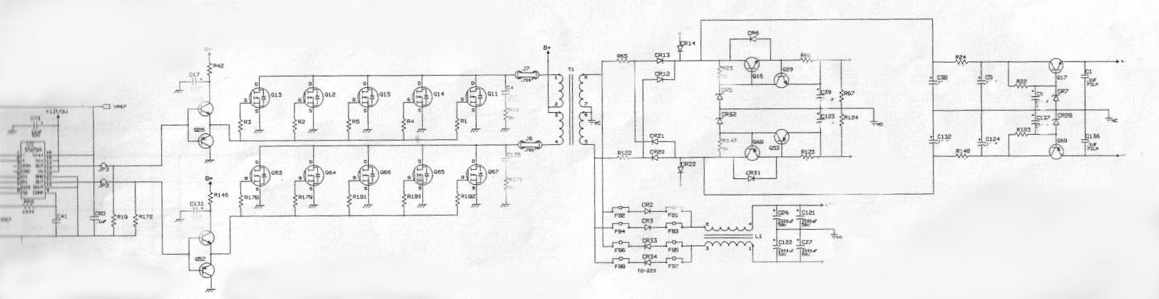

The MosFets are TO-220 devices that are mounted on the heatsink. They are called 'switchers' because all they do is turn on and off. Pin 1 is usually the gate and pin 2 is the drain and pin 3 is the source. I stated, up above, the easiest way to test these devices. The SG3525A, is a common PWM chip that is used in many switching power supplies, here is a link: http://rocky.digikey.com/WebLib/On-Semi/Web Data/SG3525A-D.pdf
My computer is being a piece of chit right now and won't let me operated my scanner. I need to reformat my drive and reinstall everything, then I should be able to scan some schematics that will help you visualize what's going on in the switching power suppies.
I'll post more after I fix by f'ing computer.

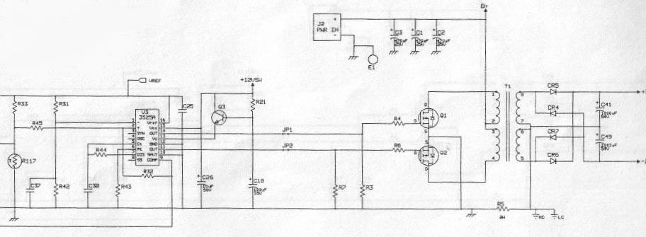

Here is a schematic showing a simple switching power supply. Q1,2 are the switchers in the schematic. Notice that the output pins of U3(pins 11 & 14) are conneted to the gate of the mosfets through R4 and R6. Also, notice that B+ is connected directly to the transfomer, and is grounded through the switchers.
