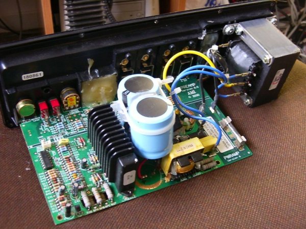

One of my friend just gave me a blown PB12, there is a class D module amp, where everything seems to be in.
The circuit seems to be repaired and looks like there was a lot of rework from factory. I know this unit never been opened by a redneck or so, my friend dont even have screwdrivers.
So, is there some schematics that i could get, or some inputs. I do think that the source of the problem is the module, wich is a small heat sink and some urethane molded behind it. When i turn it on, the woofer pops in with huge hummmmmm. Dead for sure.
Sources for this part?

Here is the complete board.
I meant by a small tranfo that is it small for a 250w amp, even D mode.
Pat Allen

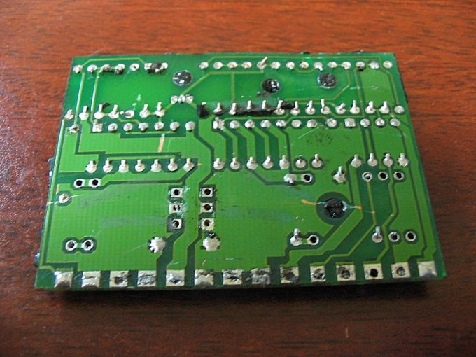

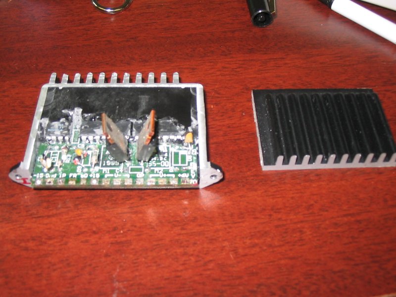

Ok, so here i am, i have opened the sealed module :) with the help of a milling. I have access to the power mosfets, wich are totaly ok.
ssanmor sent me the schematic of it all, the the inards of the module dont match with the schematic.
I think i will manage to build a new module myself, pcb,...

So, i have mastered how to remove that stuff, man that stink !!
With a light flame torch, just heat it up without scraping it with a screwdriver too soon as i did, and it removes like a champ.
I went a litle bit too strong, but if i have another module i will be able to open it without messing it all like i did.

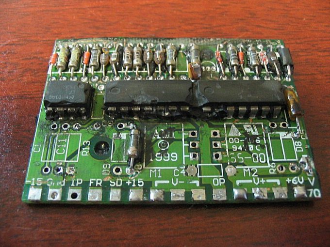

Anyway, i will do a full reverse on it.
the 2 chips are schmitt triggers, MC74ACT14AN, the small one is a LF358. There is also a small transistor, mpsa42.
All the others components are regular resistors, diodes and caps.
There is no SMT parts on this board. There is no reason why they did encapsule this part in epoxy. Is there a patent on this?
anyway, if i could only find the real schematic of it, i will figure what went wrong. Looks to me like one of the schmitt trigger have failed, since the power mosfets are ok.
any toughts?

No, they are realy schmitt triggers, i was able to read very clearly all the parts numbers.
The schematic that i have shows effectively some sort of driver, wich is a IR2111
IR2111 data sheet
I guess the module i have is the "old style" where they managed to drive the mosfet with the schmitt triggers, and the "better module" have the IR2111. It does not match at all with the schematic anyway.
