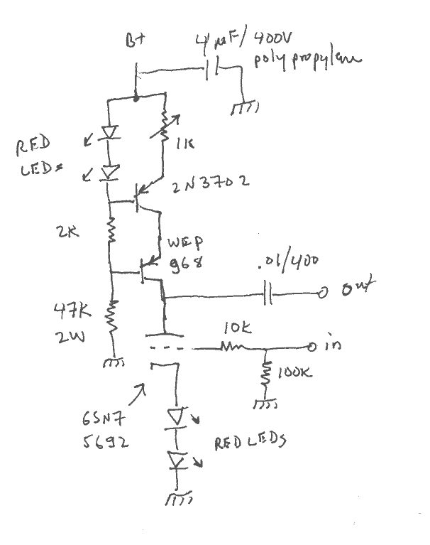

The basic circuit I used for a reference is presented here:
Note that I have retained Jones's use of LEDs to provide cathode bias. Note also that I have chosen not to use his mu follower plate load, opting instead for a solid-state cascode current source adjustable to the 8.0mA current used in the previous work. The CCS also makes use of LEDs, this time as a series-paired reference voltage source of 3.5V (2 * 1.75V). The circuit is repeated for both triode sections. With a total of 8 bright red LEDs cheerfully glowing away during the test, my garage lab takes on a festive tone appropriate for the holiday season. The use of those horrid bits of bipolar silicon to form the CCS was rationalized by considering the need for separate heater supplies for the DUT and pentode, and the inconvenience and size associated with building the pentode loads. After all, this is a TEST jig, confined to my lab, and with no need to be allowed to foul the carpet of my living room.
The parts used for the current source were carefully optimized through a resort to first principles: what parts are rattling around in the coffee cans I use as a junk box? With the engineering priorities thus set, the output resistance of the CCS is quite reasonably high: to a good approximation, Rout = hfe1*hfe2*Re. In this case, Re = (3.5 - 0.6)V/8.0mA, which is about 350ohm, the product of the hfes is about 6000, so Rout is roughly 2Mohm, safely three orders of magnitude greater that the plate resistance of the DUT. The current sources were built, then 20Kohm dummy loads were attached to verify operation and facilitate adjustment to the 8.0mA test current before attaching the CCS to the tube. For the chosen current, the plate voltages settled in at about 155-160V for all tubes tested.

I made an editing goof and didn't get the drawing of the test circuit uploaded. I'll fix it later, but the text should be sufficiently explanatory.
