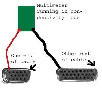

Yah I need a cable too as a few other people probably do too. I have a way that someone with a sharp cable can give a pinout to us.
Materials needed:
Sharp panel cable
Multimeter ( Run it in the mode so that when the two probes touch each other it beeps)
Step 1
Take one of the probes coming from the multimeter put it on of the pins at one side of connector.
Step 2
Take the other probe and find which pin on other end it connects to.
Step 3
Make of which pin goes to which and post please
Many thanks to anyone who does this.
Here is a picture that will help you understand what I am talking about.

looks exactly like my infocus.. large plug goes to a 'y' cable with a VGA INPUT AND MONITOR OUT. i'll post the pinouts soon. cant' guarantee anything, but it's better than nothing. maybe someone with a sharp panel will do the same? i suspect that this will end up being close to a VGA IN/OUT sandwiched together. i need to dothis anyhow, since i have 2 panels & 1 cable. good luck!

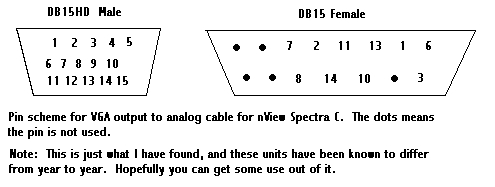

pinout
this is what i came up with, keep in mind that i'm looking at the business end of the cable itself--not the panel.
panel end:
1 2 3 4 5 6 7 8 9
10 11 12 13 14 15 16 17 18
19 20 21 22-23 24 25 26
vga end--corresponding to panelend #'s:
9 18 x 24 24
21 22 20 x 24
24 25 2 1 x
note that 'x' shows no connection and that pins 22&23 on panel side are connected.
hope this helps!
I have no idea where to buy this connector. my plan is to replace the plug on the panel with a normal vga connector, or a Db15.
p.s. had the #s nicely arranged so it looked like the cable, but they got realigned after i submitted post
Thanks a lot Icculus I'm going to try and make a cable but before I do I have one quick question on the bottom row are the last two pins before the x 2 and then 1 or is it 21.

I'm planning on making a cable with icculus's pinout soon and testing it on my sharp panel. I have found a place to buy the connector. It's called Fry's electronics www.frys.com for locations. They don't have it on there online store. The connector fits my panel like a glove. Now I just have to make the cable. Oh yah the male connectors are $2.49 a piece.
Icculus I think your pinout might be one pin off. After looking at a standard vga pinout. http://www.btinternet.com/~krazy.keith/electronics/vga.html
I noticed that you had no blue video signal. I took the blue pin off a standard vga cable plugged it in. As I thought I got no blue colors on my monitor. Maybe your infocus panel doesn't need blue?? But could you please check the third pin on the vga connector for me. Thanks for all your trouble.
