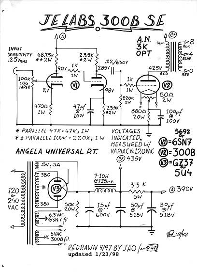

I've attached the schematic for the JE Labs 300B amplifier from Angela, which I think is a good example 300B circuit. Its reasonably simple (reasonably) and probably offers a look at a basic amplifier topology for a variety of SET designs.
Hopefully I got all the lingo right--- we're talkin' noobie here.
Let's look at the main circuit (i.e., not the power supply, right now). It seems (based on my VERY limited understanding of circuits) that the 100K pot is to vary the amount of signal passed to the grid of the driver tube (6SN7). The first half of the triode is cathode-grounded though a 470R resistor.
I imagine that Ohm's Law is used to determine the resistor value to properly reference the cathode to ground, but could someone explain this in simple terms (remember, I'm a stupid newbie)? Why couldn't the cathode by tied to ground using any old resistor (I think I sort of know why, but I want to actually, really know why), or simply be grounded without any resistor at all?

OK.
I see that those terminals are connected to pin 7 and 8 of the 6SN7 pair.
Why don't you need the same pot used in the 300B for the 6SN7 for the filament heater?
Why is it that you can connect them directly to 7 and 8?

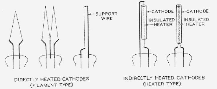

You've missed something that the 300B is famous for (and part of the reason why I think it's a bit of a pain...). It doesn't have a real cathode, i.e. it is directly heated (you have to have heard DHT: 'directly heated triode' before in marketing material somewhere?)
In the 6SN7, the part of the valve which emits the electrons is the cathode, a metal sleeve coated with alkali metal oxides, which is heated by a thin tungsten wire inside it, not surprisingly called the heater. There is insulation between the heater and the cathode, so they are electrically separate (not completetly true, the insulation isn't perfect). Thus, you can apply a voltage to the heater of the 6SN7, heating the cathode and allowing it to emit electons, and use a seperate components between cathode to ground for biasing. (One of the pins is connected to the metal sleeve of the cathode).
In the case of the 300B, this valve has a FILAMENT, like a light bulb. There is no separeate heater and cathode. The filament is like the heater (a thin tungsten wire), except the oxide coating in this case is applied directly to the tungsten wire instead of to a metal sleeve surrounding it. All the hum pots and what-not are circuitry to create a "virtual cathode", i.e. to emulate the function of the cathode in an indirectly heated valve.
I have a few pictures which might explain the difference between directly heated valves and indirectly heated valves better (from an old RCA valve manual from the late 1920s or early 1930s). When I find it, I'll post it.

The resistor value (470 ohms) was chosen to set the bias for the input valve (the first half of the 6SN7 - this valve has two triodes in one envelope). The current through the valve (this is a triode in class *1, so the cathode current is equal to the anode current, and the grid current is ideally zero) is 4.2mA. This current must pass through the cathode resistor, and through Ohm's Law, V=IR=4.2mA x 0.47K = 2V. This is the voltage at the cathode with respect to ground.
Now, the grid of the input valve is grounded through the volume pot. Why? I hear you ask. Ok, for the moment all I'm talking about is DC operating point. So, since there is no grid current (Class *1), no DC voltage appears across the part of the pot between the grid and ground. Thus, the grid is at ground potential. But hang on, I just said that the cathode was at +2V with respect to ground. Now some complicated mathematics, so bear with me. The grid is at 0V (it's grounded) and the cathode is at +2V. So the grid voltage with respect to the cathode is the grid voltage minus the cathode voltage, i.e. 0V - 2V = -2V. Phew, glad that's over.
We've determined that the grid is 2V more NEGATIVE than the cathode. For a reason that will be clear soon, this, and the plate voltage determines the standing current (bias) through the valve. (The more negative the grid with respect to the cathode, the less standing current)
Lets say we decrease the cathode resistor value. Less voltage will be developed across it, and thus the grid will be less negative with respect to the cathode. This results in more current being drawn.
Ok, lets make the cathode resistor a little larger. More voltage is developed across it, and the grid becomes more negative with respect to the cathode. This results in less current being drawn. So, you can't just use any old resistor without changing the bias through the valve and DC operating point.
The designer of the circuit chose 470 ohms to set the DC operating point of the valve. To be truthful, you need a little more than Ohm's law alone to determine it (you need the anode characterisics of the valve - basically a graph of anode current against anode voltage for various grid voltages, and need to know how to draw the loadline).

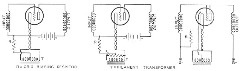

This might also be useful. It's a diagram from page 19 of the same manual showing how DH (directly heated) and IDH (indirectly heated) triodes are wired to light up their filaments/heaters, and where the self-bias resistor/cathode resistor is positioned.

what is the purpose of the 3.3K resistor
Together with the capacitor after it, it forms an RC filter. I.e..reduces ripple...or provides better DC....
one could also have used a choke ...but the resistor has a dual function really...it also reduces the voltage to a level better suited for the driver tube..(a choke has lower dcr (resistance) and therefore drops less voltage)...and is also more expensive than a resistor.

The current through the valve... is 4.2mA.
How did you determine this? Is it based on the specifications in the schematic, through the data sheet for the tube or otherwise?
You know... I think I actually get this, kinda.
In looking at the plate curves on the 6SN7 (actually, 6SN7GT) data sheet, at about 90V (which is the plate voltage, according to the schematic) and -2V grid voltage (that's Ec, right?), the plate current is about 4.2mA. So, at least I can tie back to the data sheet, which is comforting.
Now, I know that there's a reason that specific bias points are chosen, which probably has something to do with ensuring that the tube's operation does not exceed its capabilities, but I'm not sure why one point would be chosen over another.
And now, another generic and asenine question.
On the other half of the triode, there's 98V at the cathode (according to the schematic) and there's a cathode resistor that is bypassed with a capactor. Is this a bias setting for the other half of the triode? If so, why is the capacitor there?
Thanks so much for all your help.
Kofi
Easy. I cheated. 😀
Ohm's law states V=IR, hence I = V/R
Look at the resistor at the cathode.
So since the cathode current equals the anode current, the anode current is 2V/470 ohms = 4.255mA (ok, I actually should have said 4.3mA, not 4.2mA, but who cares about 100uA)
