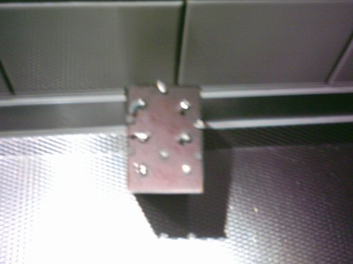

info wanted about a output transformer
hello
can anyone tell me more (impedance)about a balance output transformer
it has a code onde side. code: 28528191
if anyone has info about the transformer let me know it
thanks
If you know the turns ratio and the load impedance, the primary impedance is trivial- the load multiplied by the square of the turns ratio.
If you don't know the turns ratio, it's easy to measure: apply a known AC voltage to the primary, measure the voltage induced in the secondary. The voltage ratio is conveniently the same as the turns ratio.

That sounds like an awfully complicated way to work it out, especially since many people (including me) don't have a scope at home...
Why do you think you need to use 1KHz? I thought most OPTs should be able to pass mains frequency reasonably well.
Lets say you have a 20V RMS source (at 50/60Hz, from a small mains transformer) applied across the primary, and you measure 1V across the secondary taps you want to use (lets say the 8 ohm taps). That means the turns ratio is 20:1, hence the impedance ratio is the square of the turns ratio, i.e. 400:1. So the primary impedance is 3K2 for an 8 ohm load on that tap (calculated as 8 x 400 = 3200). Each valve in push-pull will see 1/2 the turns, or 1/4 the impedance of the transformer, so you'll have to plot an 800 ohm loadline.
Voltages measured with a DMM on "RMS" mode - yes, I know many don't measure true RMS. And of course you'd have to have some way to identify the taps.
I have heard of people measuring the primary impedance by applying the mains power to the primary (i.e. 240V RMS here), but I'm not sure about how safe that is (though these transformers were designed to handle rather large voltage swings on their primaries, hmm....)

jueic said:
How about P-P OPT ??? Can I use the same way and divided by 2 ( or 4 ??) for each side ??
What do you mean?
Find the turns ratio, square it to find the impedance ratio and then you can find the plate-to-plate impedance for a given secondary load.
Each valve sees half the turns, or one quarter the impedance of the primary. So when plotting loadlines on composite characteristics, plot 1/4 the plate-to-plate impedance.
So if you have a PP OPT with an 8K primary impedance (plate-to-plate), each valve sees 8/4 = 2K.
At least that's how I think it's done.... damn, I always get confused when trying to explain things.....:(

Hi, Audiosername
That is the spot-on answer for me... I was wondering eihter the primary impedance is 8/2 K or 8/4 K..
