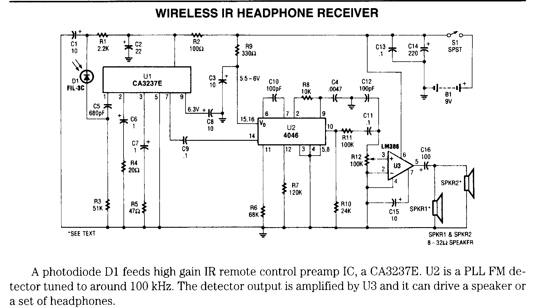

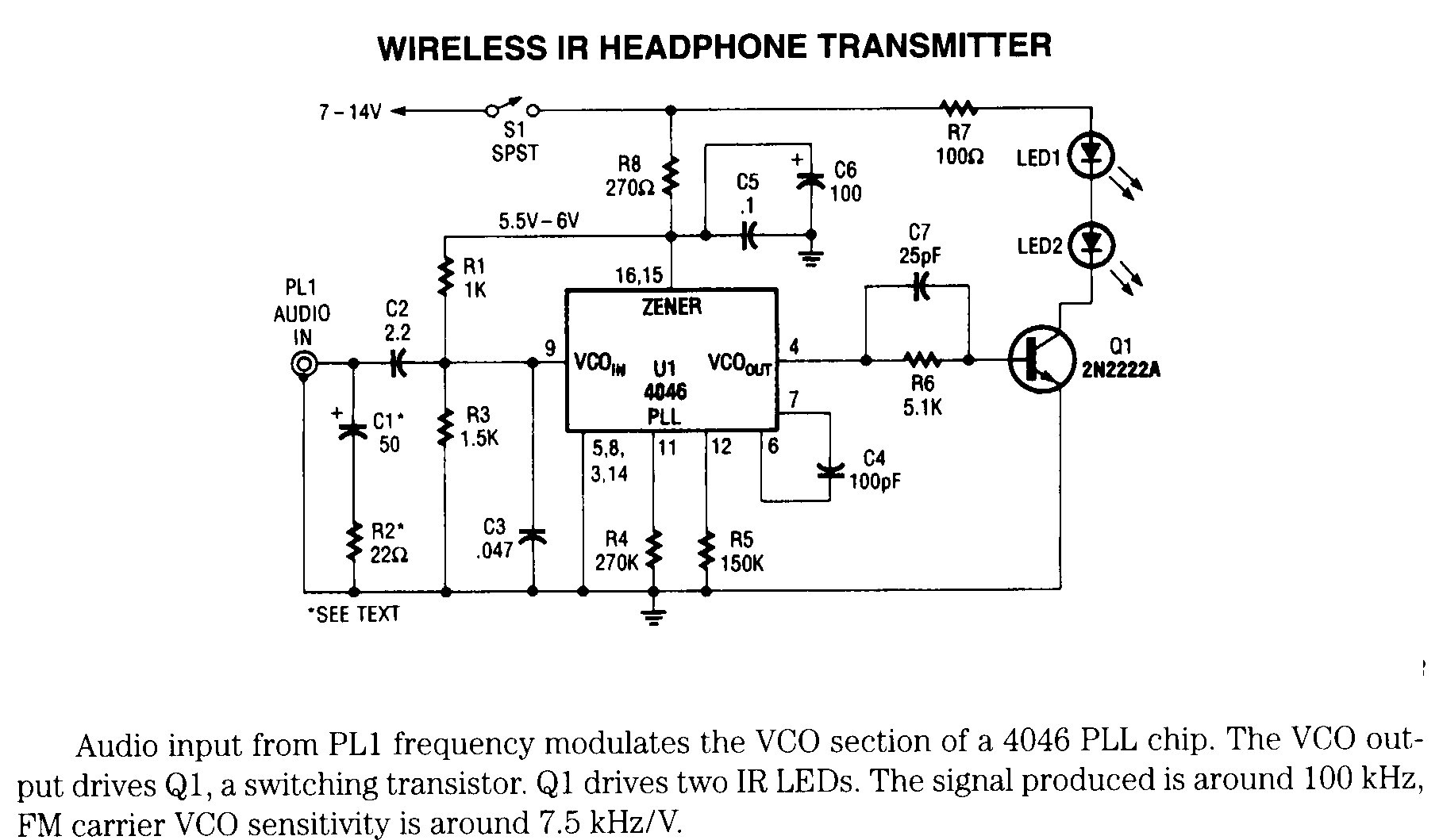

Hey sivan_and;
Looks cool. If you don't want to user the LM386 you can take the audio into your own amp. Yo may need an opamp (LM833 etc) if the level isn't high enough.
Cheers
Cheers
Yeah my amp will be LM3875. Substituting IC CA3237 is another problem that has to be solved.Had to try some amplifier incop in IR receiver.
