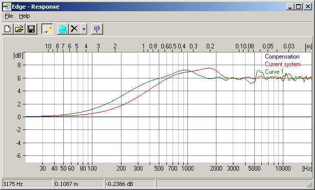

Well I finally placed the order for my drivers yesterday. I couldn't believe it when I looked back and had sent an email a more than a year earlier saying I was about to order them!
I'm getting 4 X Morel MW144's and 2 X morel DMS37's , plan is to make two MTM's and sit them on top of (eventually) new cabinets for my 2 X Vifa M26WR-09-08 10" woofers.
At this stage I'm thinking about a passive 1st order crossover on the morels, and active on the woofer / MTM. I'm also thinking of being a bit unconventional and crossing the woofers at about 200 Hz so they won't be subs, sort of like a hybrid active/passive 3 way.
I wish I had never heard of baffle step!!!! I'm tempted to just ignore it and hope for the best, but don't think that is a terribly good approach.
Main problem I'm having at the moment (with the baffle step), is that since I'm planning on having separate cabinets for the Woofers, I'm not sure whether I should try and match the baffle step for the woofer and MTM by having the same width cabinets (would mean wider cabinets that I would like on the MTM). I'm just worrying that it may complicate things excessively if I have two different baffle step curves due to the different cabinet widths.
Using the Edge (thanks Svante) If I go with an extremely narrow (280mm) baffle for the woofers (yeah I know) and a 200mm baffle for the MTM’s the difference at 200Hz is only a bit over 1db (woofer ~1db higher than MTM), and the woofer is already down almost 3db at that point. My gut feeling is that if I did this could I safely ignore baffle step compensation on the woofers and only worry about it on the MTM’s…… does that sound reasonable, construction issues aside 😉
If I go with a low order active crossover for the woofer/MTM, could I simply set the gain on the woofers amp a bit higher and do away with the baffle step completely??
Curve 1 in the attached picture is the curve for the woofer with 280mm wide baffle, the other is for MTM with 200mm wide baffle.
Tony.

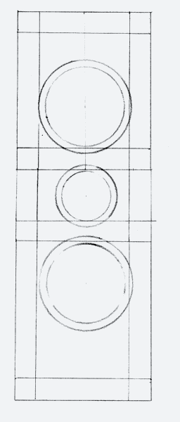

OK, I thought maybe I better start thinking about the cabinets a bit more seriously than I had already. The plan is to have partitions in the box to separate the two midbass drivers from the tweeter. I've drawn up a rough sketch....
the walls will be 25mm MDF but they look a little thicker as I have allowed for 6mm sound deadening material as well. What I'm wondering is whether having the drivers so close to cabinet walls is a bad thing. I'm going for a narrow cabinet for imaging, and also trying to get the midbass drivers as close to the tweeters as possible.... I'm thinking maybe I should reduce the partitions to 18mm MDF to get the tweeter a little closer to the midbass drivers.
any comments welcome 🙂
Tony.

the technique of XOing in the region of the baffle-step is a good one... with an active XO you can slide the XO up & down to get it in the right place & adjust the relative levels with ease.
dave
dave
Thanks Dave 🙂 nice to know I'm not going completely insane 😉 I guess experimentation is the key!!!

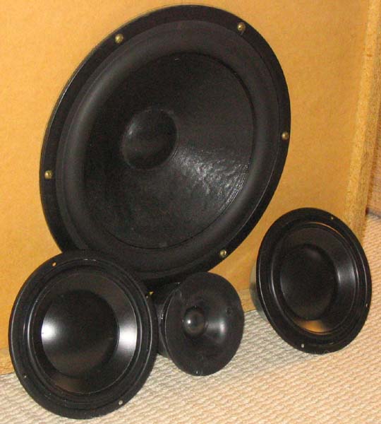

PS. decided to attach a pic of the drivers
edit: and yes I am going to build new cabinets for the woofers!!!!!!!
