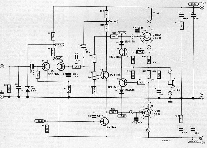

"100W power amp. elektor april 1982"
this should be the one 🙂
Yes!...this one, ...John Mateus constructed this one and told me
That distorted the high frequencies.
I suggest him to:
- Reduce C7 and C8 to 10 picofarads
- Reduce C6 to 27 pf
- Remove 470pf from the input, unless you have one radio
amateur near you....less than 1000 feet,
- Include some capacitor (100N) in parallell with D1
- Remove the "distorters"; T5,T6,D2,D3,,R19,R17,R15 and R13
- Include a 1 uf non polarized capacitor from bias coletor to
emitter (t2)
- Increase C7 (input cap) to 2u2, use poliester, non polarized
Glue a cartoon (isolation) over a copper plate, the same amplifier size... and put it under the amplifier board, and connect this plate to ground...the amplifier likes to oscilate, that's the reason they put the "hinderburg", enormous "Aphocalipthic" capacitors from base to colector in the darlington units...they have big gain and like to oscilate....10 pf is enougth to block oscilation without destructing the wave shape.
I do not know if Mateus made those changes, he is a big friend o me...but the one is older than "mathusalém"....and may be forgot made the amplifier, and if that thing is an amplifier or an ashtray....ahahahaha...he will say terrible things to me.
Say terrible things...but talk with me..... if you forgot me friend, will be worst!!!
regards,
Carlos

Oops, forgot that one, it is not 100w in 8, but in 4 Ohm.
The one i mentioned must have been from the end of '82. A bit more power too, at least 130 watts in 8 Ohm.

The only modification i made to the schematic were two diodes 1n4148 from base of T1 to T2 (both in a different direction) to keep the input voltage within some limits.
Still have it up on the attic, sometimes i use it to make some noise🙂 🙂
That's picture is right! That's it. :smash:
But he changed something.
He change the output darlingtons with MJ11016 and MJ11015.
1 What do you thing about this modifying?
2 What circuit you suggest me to do? I want to build better transistor amplifier than this amp.

There was some confusion regarding this (or the other) amplifier.,
It turns out there are TWO diferent amplifiers published in 1982 by
Elektor, one is this with darlington outputs originally BDX66 and 67,
the later published latter in December 1982 and baptized as the
Crescendo with MOSFETS outputs...
In January 1983 Elektor published Accessories for the Crescendo
a circuit for power up delay, protection and so on... In November 1983 there was an article with Modifications called Crescendo revisited with a very small modification to prevent oscillation.
In May, 1984 Elektor published another version of the Crescendo
this one smaller, with less power, which I built too....I guess I
was a big fan of the Crescendo at the time....But I'm cured now!

However, a few years latter I built the one with darllington outputs
which doesn't have a name, probably because doesn't have parents
(é filho da p....), but in fact it is a much better sounding amplifier even
though it ended up again in a box full of junk.... A couple of months
ago, due to the fact that I had a different design (only aestheticallly
which made me not to recognize the amp), I built the SAME amplifier
and spoke to Carlos about it asking him to do an evaluation to the guy...
About that Carlos and I had a little quarrel because (again) I did not
recognize the amplifier on the simulator as the simulator didn't have
any darlingtons in its data base....
Well, to made story short I built the amplifier AGAIN and for that
I did another layout which was completely different from the first
one (how could I recognize the beast from the other animal?).
I did not change any value of components except the small input
cap for radio freq., and the amplifier is perfectly stable and easy
to adjust, supplies the power for which it was designed (around
50Watts) and finnaly is very pleasant to listen to. Nothing of that
Hi End nature, but very pleasant...
And this the history of the atribulated and already famous Elektor
amplifier...Do you guys want to know something? Even though
it doesn't have a reputation of certain amplifiers that everybody
is talking about as being this or that, not to speak about the ASKS
more elaborate ..or less definitions, this amplifier is definitelly a
WINNER. End of story......
