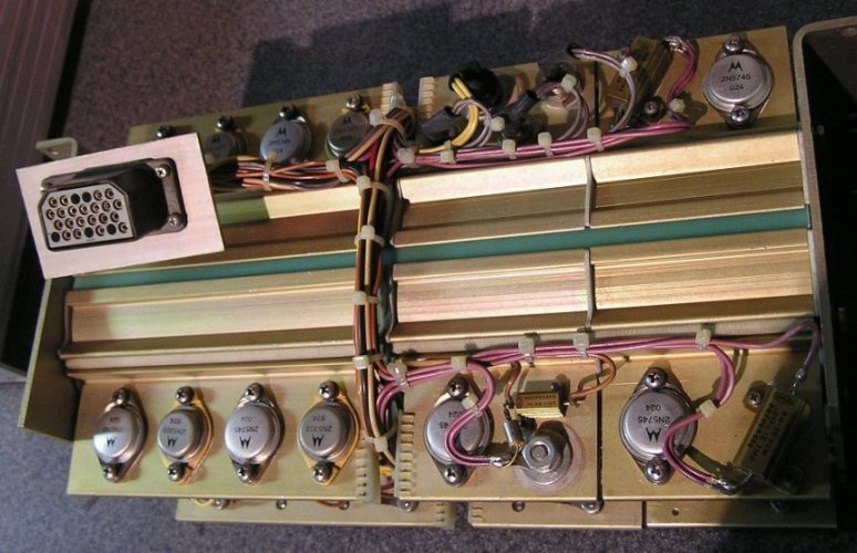

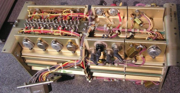

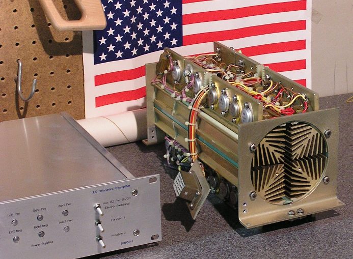

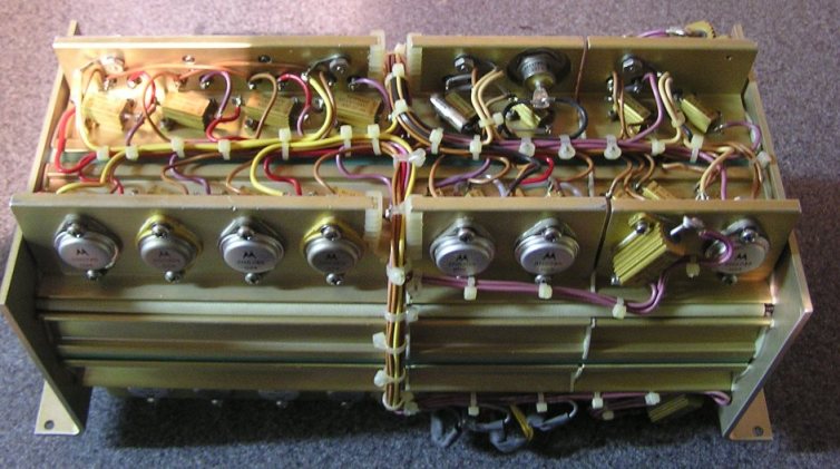

Funny thing about DIY, its got me visiting surplus stores looking for chassis, heat sinks, and other DIY matierials. Picked up this for $20, kind of expensive for "junk" but figured I could use the heat sinks. (Its the one on the right, the one on the left is my BOSOZ preamp shown for scale. See the preamp here).
Looks like an amplifier, its got lots of transistors and high power resistors. A real work of art, it will be a shame to take it apart. Looks military. Its pretty massive, perhaps suitable for an Aleph X or something?
Anyone know what this is? Ideas for the parts, are they any good? Was it a good deal or did I spend too much?

It looks like an industrial quality motor drive amplifier. It is usually relatively low voltage, high current, with a current output rather than voltage output. It will have to be completely changed to be useful, but the heatsink, itself, is worth what you paid. You can put a whisper fan on the end and still get good cooling, however, you must use a fan.
The esteemed Mr. Curl is quite correct... but I can add one thing.
The heatsinks do come apart, and you get 4 very nice extrusions
which can be used vertically for pretty decent convection cooling
applications, but of course not at the same power levels that you
could with the original fan blasted method. :D

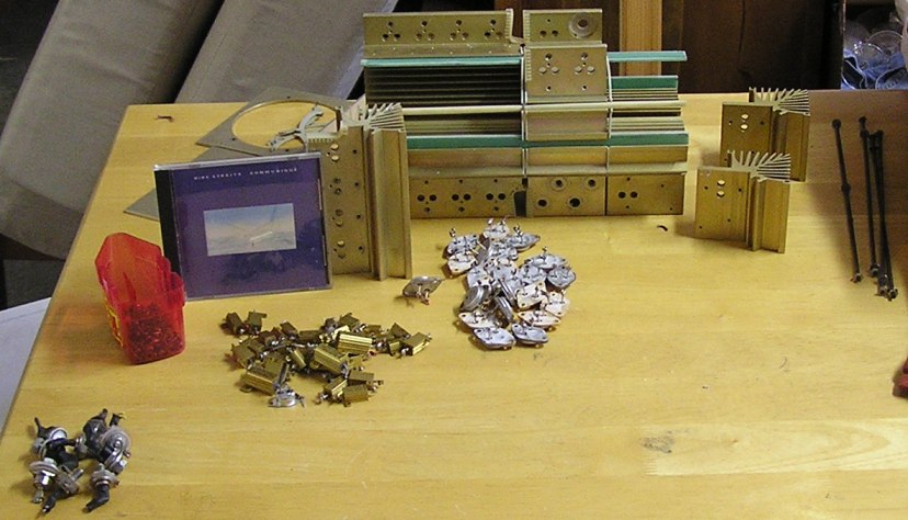

Amp disassembled
Here is a picture of the disassembled amp. There are 4 big heatsinks and 8 small ones, and a lot of power devices.
The heatsinks do indeed come apart and can potentially be used standing up. hmm...

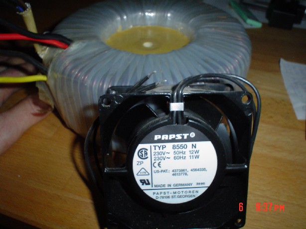

What a shame, what you have there is one heavy duty Ram Jet intercooler.
Oops, i am talking Chevy again, wrong thread !
However, on that picture i see plenty Heavy Duty armor Dale resistors to slow down a low dBA alloy long life Papst vent.
Personally i like vents to suck cooling tunnels instead of blowing.
(oops again, am i reading my words correctly ? )
Op top of that, the Dales bolt right on the duct, not even the holes need to be tapped.
And, MJ150024, MJ150025 or something like IRF244's fit there too, by the dozen.
Mr Green, you are not seriously considering them erect, are you ?

Don't know if this is Bubba's brother or cousin or something, but here is what came from it:
9 Motorola 2N5303
13 Motorola 2N5745
4 diodes 1N188R
3 diodes 1N1188
1 diode 1N1186
1 diode 1N1186R
I will follow your suggestion and use MJ21193/4 to make a Krell KSA-50 clone as being discussed here in the Solid State forum.

Hi, I have taken several of those apart. The ones I had were the power supply and servo amps for a big reel to reel computer tape drive. I would have killed for one of them years ago. The power supply was 36 volts + and -. The transistors were 15 amp 80 volt compliments.
I used the emmiter resistors and replaced the transistors with MJE15024 and MJE15025. Made for a neat looking amp! I have two more tunnels that were the vertical deflection amps for an old monitor. What a find! I have them sitting on a shelf just waiting......
