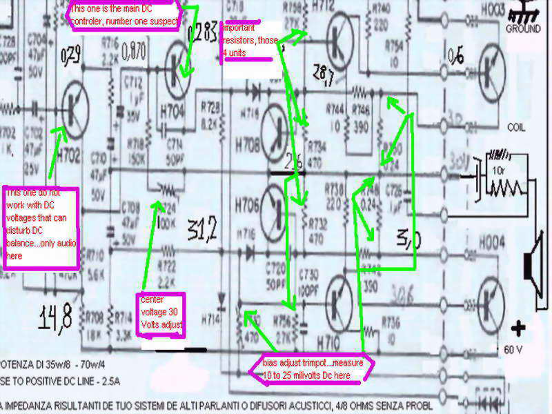

Your amplifier center line, the output line must measure half the positive voltage.... exactly..... plus 30 volts in your case if i can remember....maybe some mistake....i have to check schematic...latter...now i cannot.
regards,
Carlos
R723 and R729, those trimpots will control the output line...
Will control the output line voltage (30 Volts) and will control the bias...... if well adjusted, over the 0.24 ohms resistors you must find from 15 to 25 milivolts...measuring DC directly over those resistor leads.... from ground to center line 30 volts.
Check those trimpots, check if someone is oppen as result of crack or over current burning the resistive rails...they used to work around the middle position, normally factory do not calculate those things to be adjusted in the maximum or minimum.
The guilty can be one of the transistors that are associated with those trimpots, as they adjust very important currents.

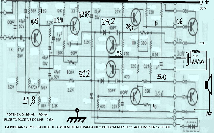

This schematic may be easier to read
Take a look.
Carlos

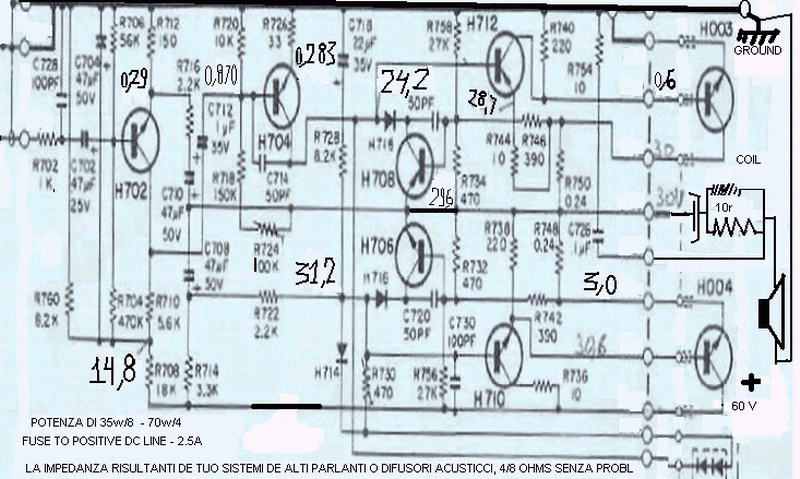

UOOPS!!! I made supply invertion, both schematics already published are wrong!
I changed positive to negative, because used the lower half schematic....that one, beeing simetrical related the other channel, have the ground up.
In real life, without protection resistor or very fast fuses, your amplifier will burn a lot of parts.
But this happens when we assemble... already done amplifiers is a little bit difficult to make that.
This circuit is corrected related the invertion...use this one as a reference to your work.

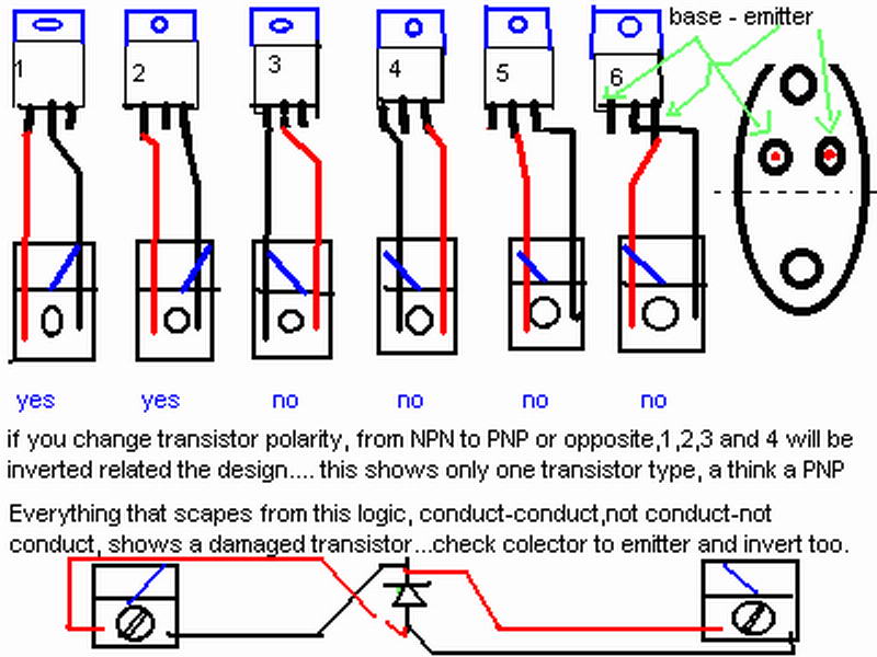

Giaime, in my mind, transistor is transistor and not more than transistor, it have tree leads, one is base, second colector and third is emitter.

Now i am thinking, doing as exercise....but remove and test is faster... and the answer will came...if you do not need to prove nothing to yourself.... just remove, test them and substitute them.

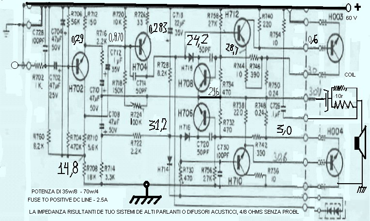

I've looked at the amp, and it turned to be H704 that was open from B to E (checked either polarity with a DMM set on "diode test"). I will go to the shop in the next week, I've got too much to study at school this period!
Do you think I should sub both the two transistors on the two channels? I plan substituting it, as you can't predict what you will get from a 30 years old and probably overheated transistor.
And should I put a dissipator on it? It is a 2sc875d...

Quote:
"Do you think I should sub both the two transistors on the two channels? I plan substituting it"
Certainly wont hurt, however if your going to do any
preventive maintenance I would also focus on the passives
mainly the electrolytic caps when they get this old they can
cause lots of problems.
