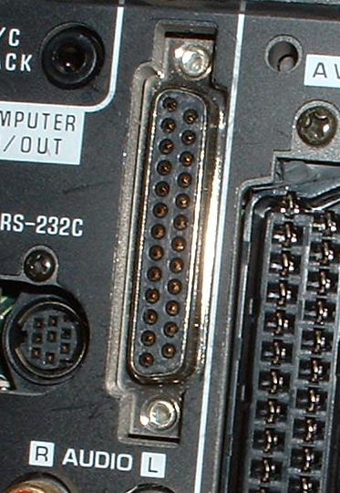

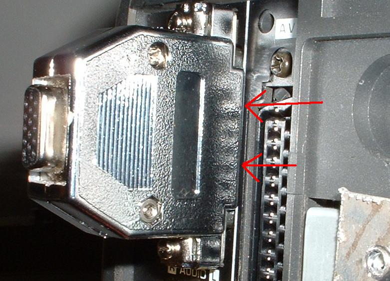

The DIY cable ends have a part of the hood that comes around the connector to retain it. Problem interference with the projector cover. Molded factory ok, I also think skywayfiles2 has found a solution to modify his cables instead of the projector.

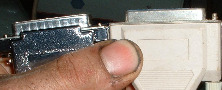

Here is what I saw, part of the cable hood made contact before the plug was fully inserted. I was able to get a signal threw but a bit touchy. I ran an unshielded printer extension cable for a quick test of the adapter.
My method could have been improved by scribing lines and carefully making sure I stayed straight in them and so on. This part of my already frankensteined unit has its back to the wall on a shelf about 8 1/2 up. So looks are not too important
